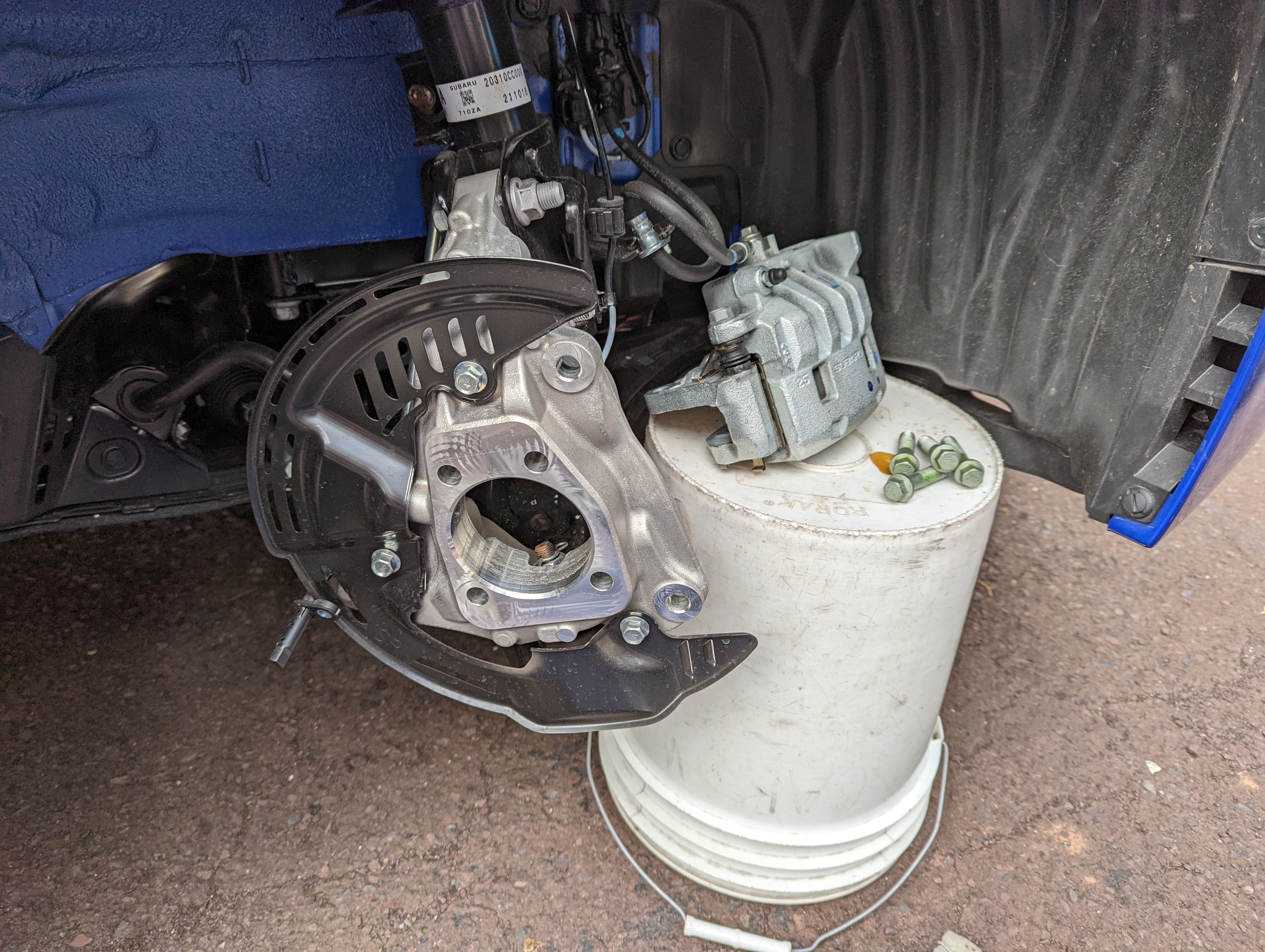

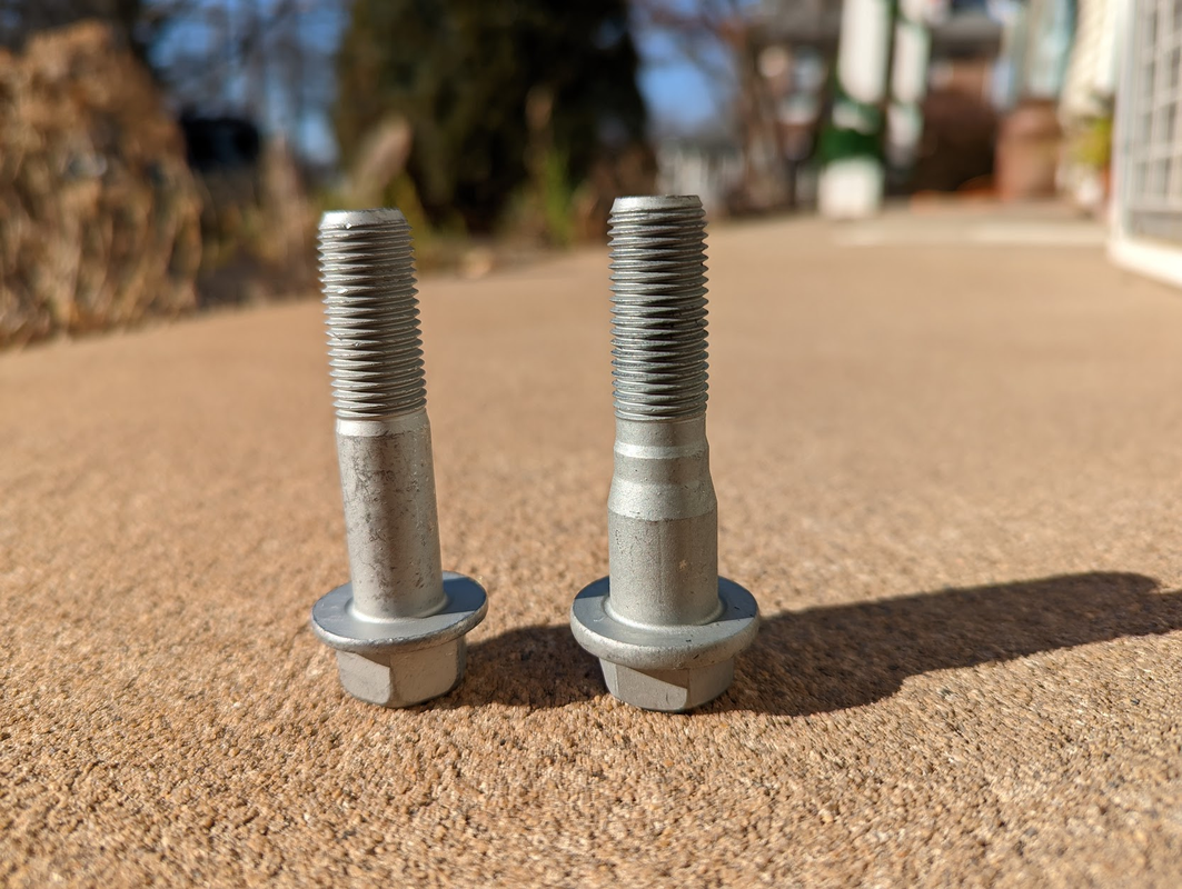

I installed the OEM crash bolts. I got around -1.3 degrees of camber on both sides with my camber gauge. Toe was nearly unchanged, as it was on the first gen.

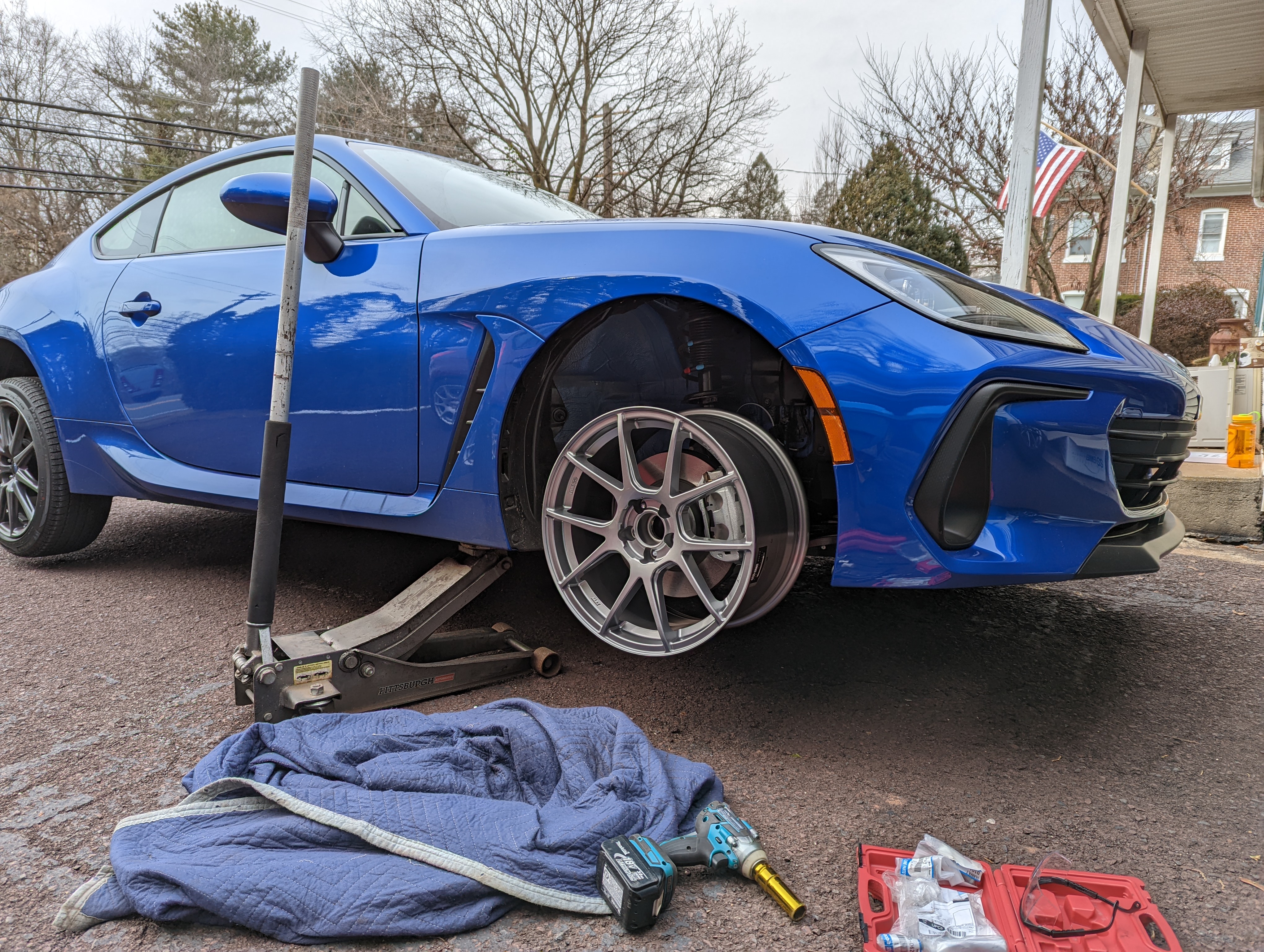

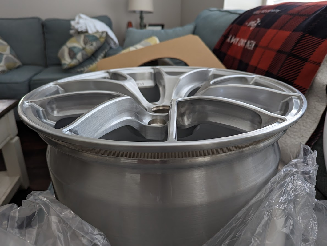

Got up to two things today! Received my new wheels, 17x9 ET45 Enkei TS-V in Storm Gray. I'm really excited to see them on the car properly especially with my incoming coilovers from Shaftworks USA!

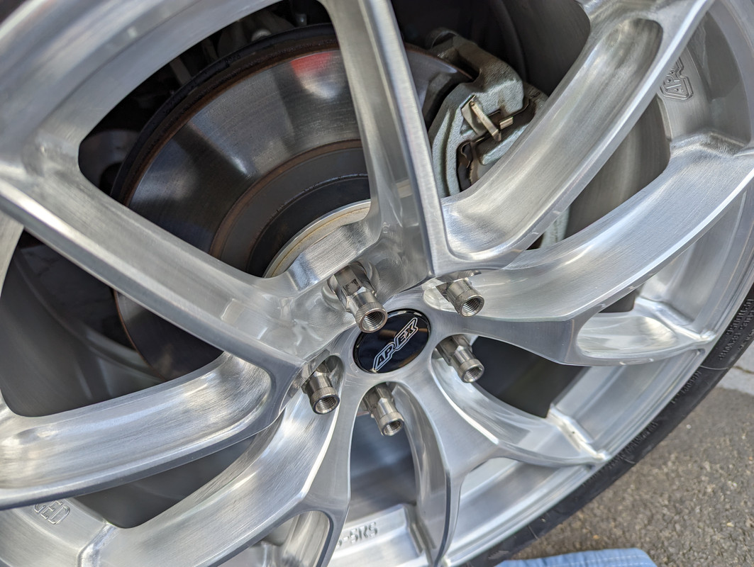

I installed Eibach's 10mm extended stud/spacer kit using the balljoint spreader tool method on my 2022 BRZ today. Pretty simple as it is on the first gen or most other cars. Warning though, the 2022+ BRZ with aluminum knuckles uses different torque specs than first gens (now 88.5 ft-lbs for the two caliper bracket/knuckle bolts and 70.1 ft-lbs for the four hub/knuckle bolts) but more annoyingly, the knuckle is in the way and there's no way to install extended studs without pulling the hub. Not a huge deal and overall pretty simple!

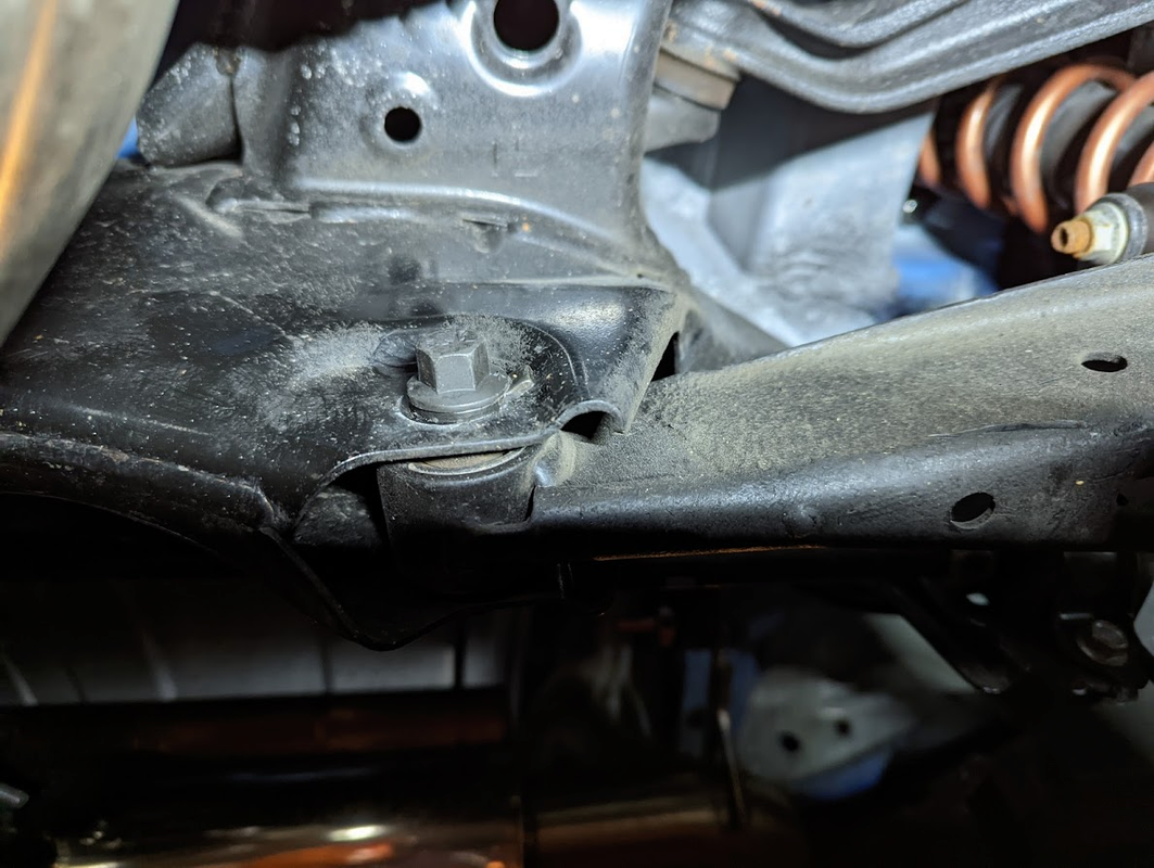

Installed Whiteline's subframe bushing insert kit. Seems to fit fine even with the new swaybar mounting on the BRZ. It will definitely fit fine on the GR86.
There's definitely a bit of NVH, but the rear end of the car feels more connected. Trade offs!

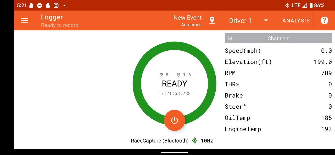

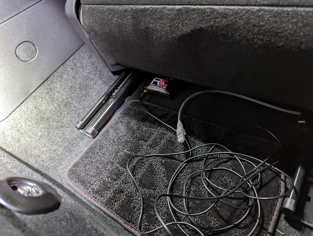

I've been working on mapping CAN data and finding a nice access point since CAN isn't readily accessible on the OBD2 port anymore. There's an active sound (ASC) computer easily accessible in the passenger side of the dash, so that was a perfect spot to "hack into" and get CAN access.
Parts list for the ASC connector/patch harness:
Male connector (plugs into factory harness):
- AMP/TE Connectivity Connector Housing P/N: 1376106-1 (Quantity 1)
- AMP/TE Connectivity Pins P/N: 1376109-1 (Quantity 8) - I'd suggest ordering a couple of spares though in case you mess up crimping
Female connector (same as factory harness if you're making a patch)
- AMP/TE Connectivity Connector Housing P/N: 1318386-1 (Quantity 1)
- AMP/TE Connectivity Pins P/N: 1123343-1 (Quantity 8) - I'd suggest ordering a couple of spares though in case you mess up crimping
I used this wire: https://www.amazon.com/gp/product/B0...0?ie=UTF8&th=1
I used this RJ45 breakout (for RaceCapture Track Mk2, you'll use something else for other devices): https://www.amazon.com/gp/product/B0...?ie=UTF8&psc=1
Use something like this to crimp the connectors. It's fiddly and annoying but way cheaper than the "right" tool: https://www.amazon.com/Qibaok-Termin.../dp/B089LW7MWT
If you're wiring to a breakout like I was, this will work to make the ferrules on the wires. Way nicer to insert than stranded wire twisted together or whatever: https://www.amazon.com/TICONN-Insula...dp/B09F94TPRV/
My patch harness (made a second for a friend that I owe a favor to):
My RaceCapture "install" after I routed the RJ45 cable along the passenger side rocker under the carpet, down in front of the seat, and out the flap that exposes the chassis VIN.
Data into SoloStorm!
Matching temps on the dash for comparison:

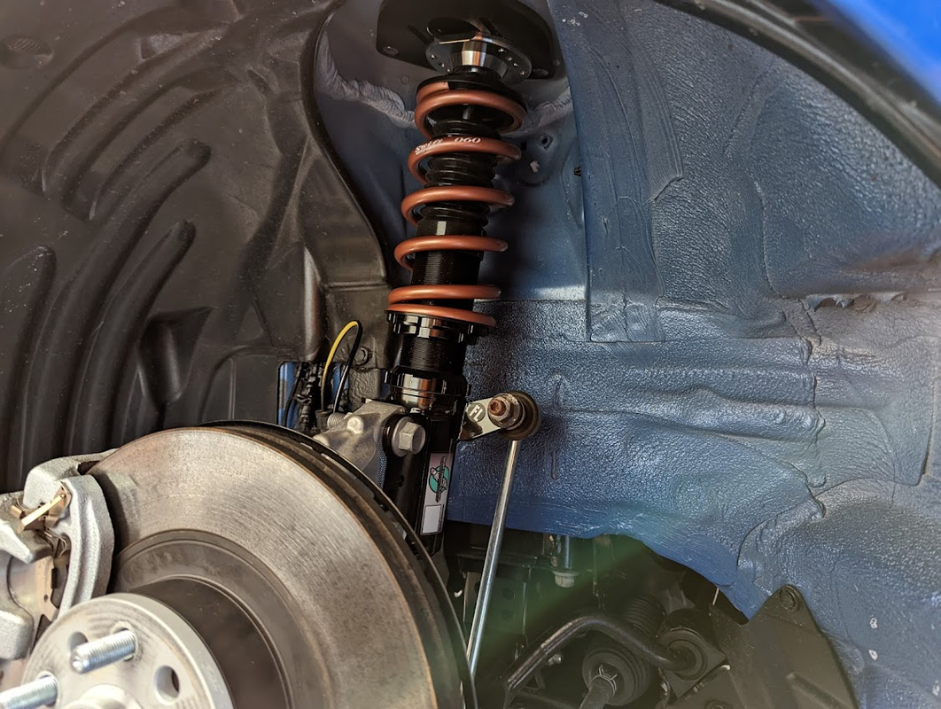

Shaftworks USA Bilanx 1 coilovers installed! Rides like stock, I'm really impressed considering the spring rates and valving we went with. Gotta do a front swaybar and finally mount up my tires on my TS-Vs before I can comment much on their performance otherwise. Winter is finally over and I'm excited to go autocrossing and TT

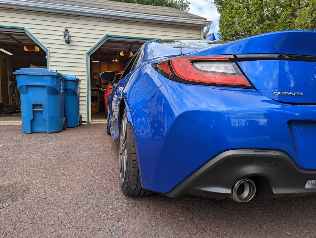

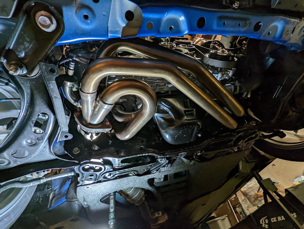

JDL UEL & Perrin 2.5" catback installed! Sounds like a proper Subaru again, haha
I did the header first so I could see how it sounded with stock exhaust:
Cold start with the header and catback and some free revs:
Cruising around:
Full throttle 2nd gear acceleration:

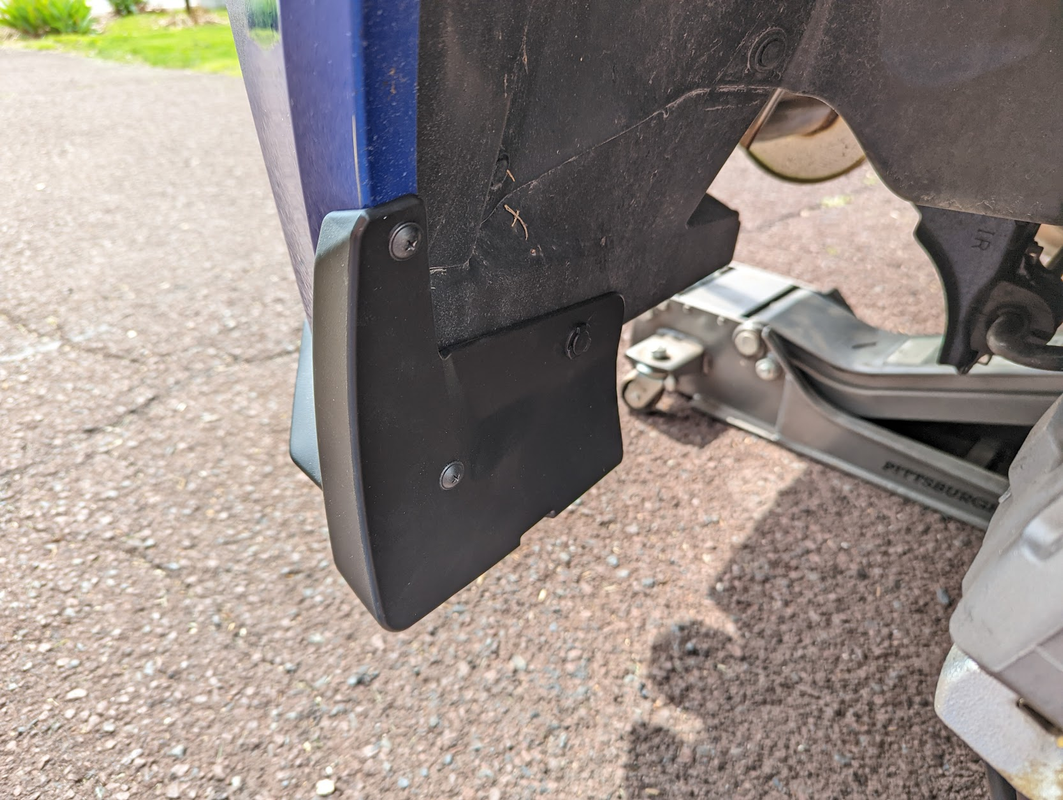

Installed the Toyota OEM mudflaps. Not quite as much protection from the front flaps as I'd like, but that's OK.

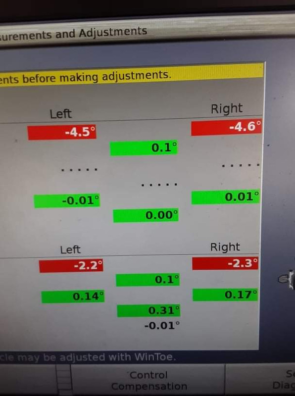

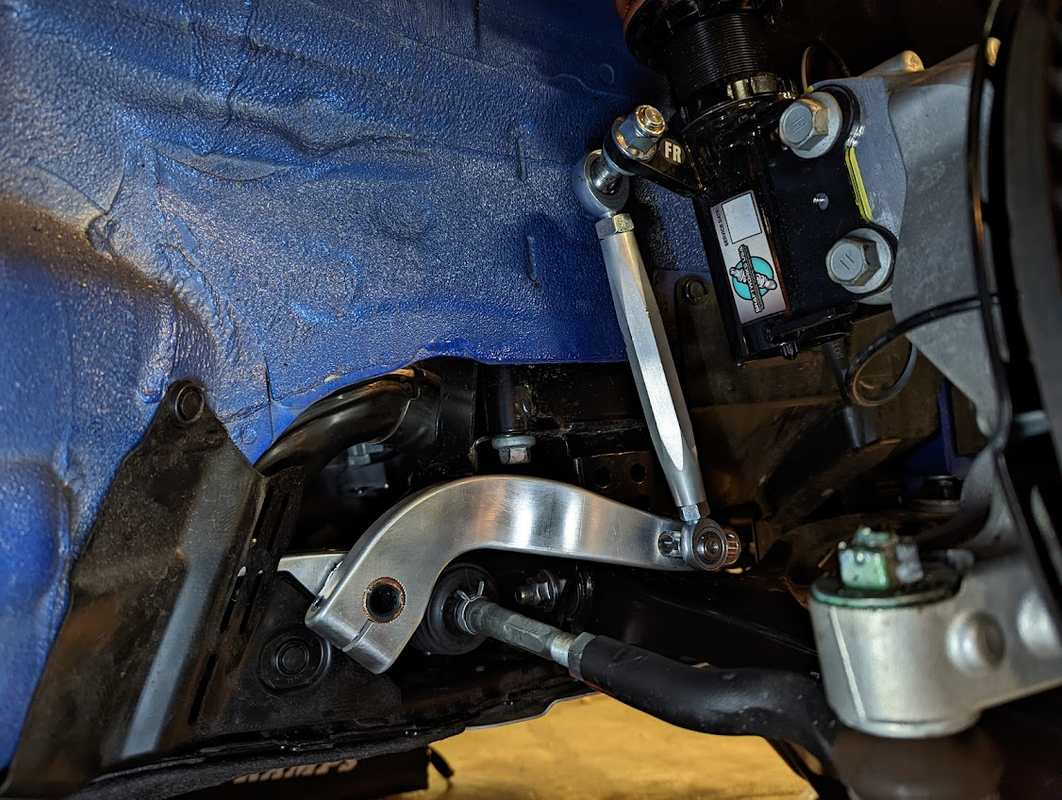

Needed more rear camber! Rear lower control arms from the first gen aren't legal on the new car due to a change in motion ratio, makes this mildly annoying but oh well. The only other options are a $650 set of upper control arms or a $130 set of offset upper arm bushings that are a huge PITA to install and adjust as well as being easy to have them slip...
I'm giving a $25 option a try I got ~0.3 degrees more rear camber (one side gained like 0.5 degrees, so I just evened it out) using two MOOG K90473 camber bolts. They torque to about the same torque spec as the OEM bolts so I'm hoping they don't slip. I'll find out soon!
Alignment before:
Alignment after:

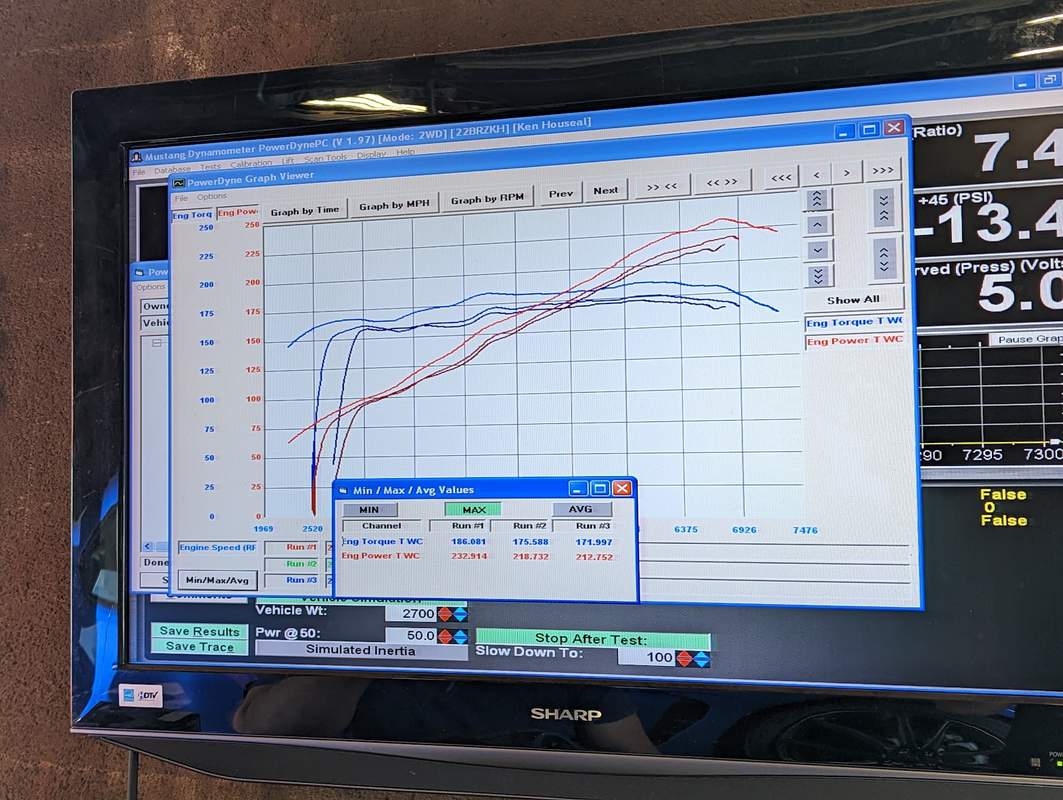

Tuned today with Mike from Xero Limit. JDL UEL, ISIS Overpipe (left over from my first gen and they've since rebranded for obvious reasons), CSG Catback, and K&N panel filter. Charcoal filter in place.
Lower two pulls are stock tune with all of the same mods.​

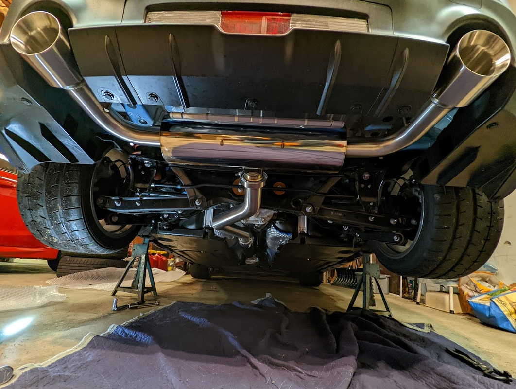

Replaced the stupid huge tips on my exhaust with some aliexpress tips that are knock offs of Akrapovic's Ti tips

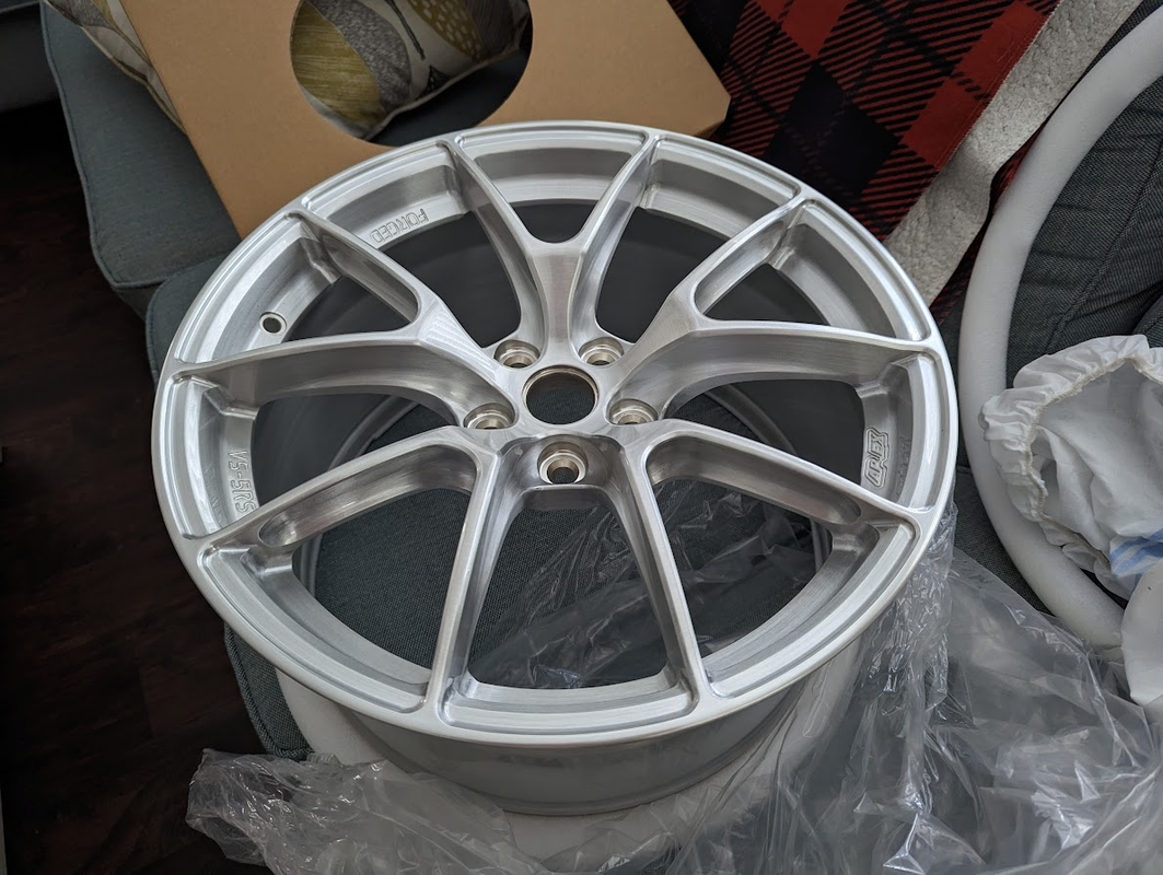

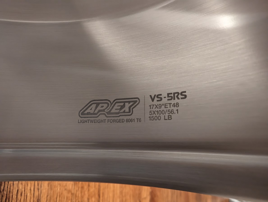

Finally got my APEX Racing VS-5RS wheels that I ordered in July...

How are those rear camber bolts holding up? No slippage I'm guessing?
No slippage, they've been great.

Not the greatest pics... I've gotta clean up the car and install a little longer front studs before I can go anywhere for better pics. Only 5.5 turns of lug nut engagement with 13mm front spacer compared to the 10mm spacer I was using before with the Enkeis, not quite enough!
These are the APEX VS-5RS, 17x9 ET48

Old 04-26-2023, 09:17 AM   #12
DocWalt
DocWalt's Avatar
Drives: '22 BRZ
Location: PA
Posts: 1,969
Thanks: 2,446
Thanked 1,707 Times in 861 Posts
Mentioned: 25 Post(s)

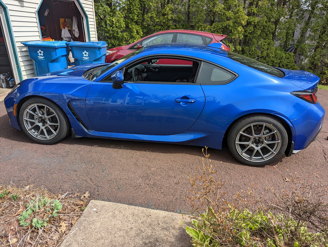

Replaced my Eibach front studs with ARP for a bit of extra length for more spacer options, mostly so I could run 13mm front spacer for my new wheels.

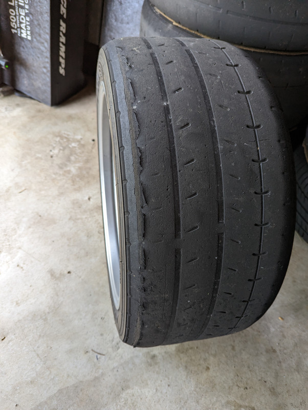

Found a shredded A052, sadly. I was hoping to use the rest of this (very bald) set of tires for a Track Night, oh well.
New wheels installed with 13mm of spacer up front.
DocWalt is offline   Reply With Quote

That "raw" aluminum finish on the wheels is really unique. Looking good! I like the contrast of the silver wheel with the WRB paint.

I love the "brushed clear" finish, it pops so much. Even my coworkers were like "wow what did you do to your car, it looks great?"
