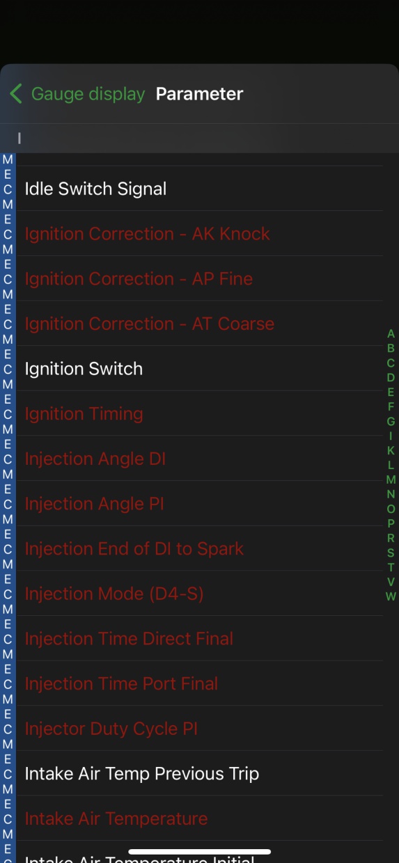

Just checking to see if this is unique to my car or if others have run into the same issue. Plugging in my ecutek dongle and loading up their app I can connect no problems but basically none of the info is useful. I can get rpm and inconsequential things like if the ac compressor is on but nothing useful like IAT, MAP, any fluid temps, nothing.

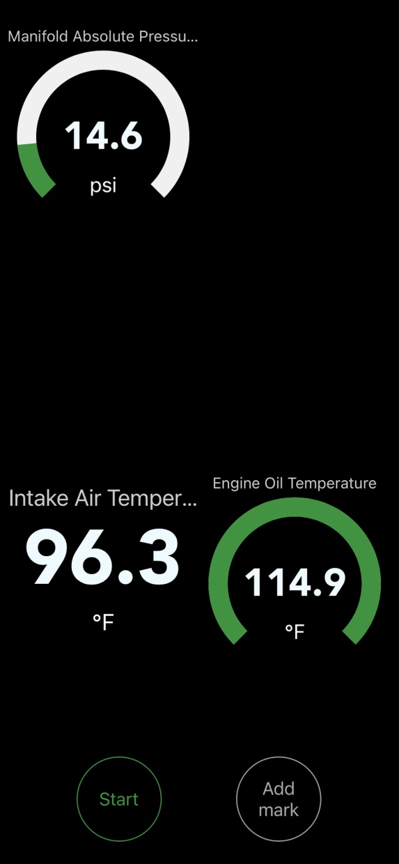

Well I feel like an idiot. As you'll see stuff like IAT is in red so I just assumed you couldn't select it. Turns out that is not the case. I'm not really sure why it's red but I can put it on the dashboard now.
