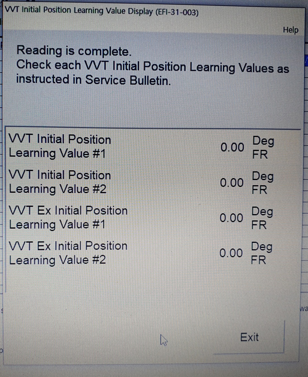

When I chased my non-operating vvt issue https://www.ft86club.com/forums/showthread.php?t=138803 , I've experienced when flashing new ecu image the initial learning values cleared. ECM was not changed.
I solved that vvt issue after changing four cam sprockets and cam chain. Ah, reflashing was done also because I do it frequently.

What equipment did you use to clear everything. I have done the chain, 4 cam sprockets, 4 ocv's, and the 2 sensors. Mine is with the P0018.
Tactrix Openport 2.0, EcuFlash and Techstream software. With Openport, no Techstream cable required.
Hope you have good result.
