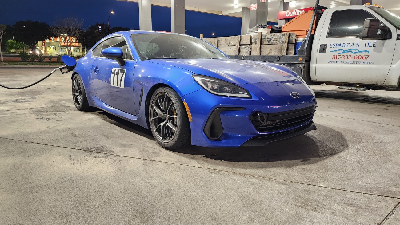

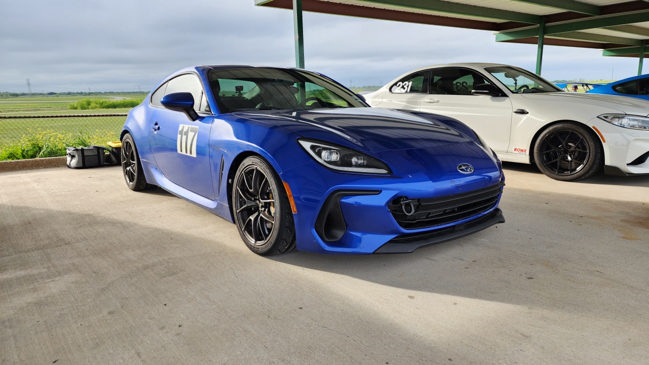

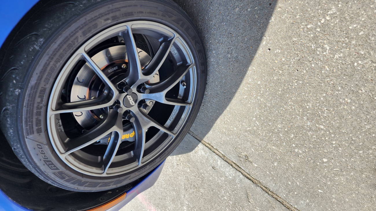

I didn't quite do this all today, but AP Racing Sprint Kit, Ohlins, SPL LCA's and toe links installed on my car. Just an amazing combination. The brakes feel so good and the suspension is just perfect now.
Looks great. Are those wheels 8.5 or 9" wide?
They are 8.5! I wanted to go with 9, but my car was stock at the time I got them and they wouldn't fit without modification. These should do fine though.
