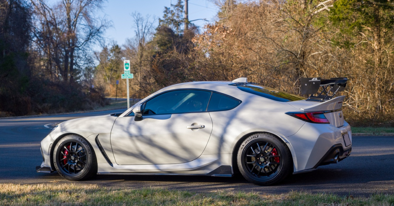

You do not need Uber huge brakes for the car. I read the other thread. I swapped to the Brembo BM4 from CSG and optionally the rear Brembo GT kit. You don’t need the rears but I prefer fixed calipers. Fits my 6UL, though I wouldn’t run those wheels on track. They are my beater street wheels and they are kinda ridiculous thin.
You’ll barely be exercising the BM4 kit. Don’t even bother thinking about ducts. See my build thread for more details.

Current street setup
