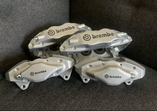

I saw this Brembo on sale, but noticed that the piston size is different, AFAIK the PP Brembo use the same size 40mm piston?
Yes, the factory Brembos for the twins are 40mm for all pistons on the front calliper.
That said, FWIW, a lot of aftermarket Brembo kits for these cars are using 38mm & 40mm stagger, with some shops claiming this is even more ideal. Whether it's truly more ideal or not, I'm not qualified to say, but it would seem that even if it isn't more ideal, it shouldn't be much worse than the factory setup.

Brembo and AP Racing aftermarket BBK use staggered pistons to prevent pad tapering.
