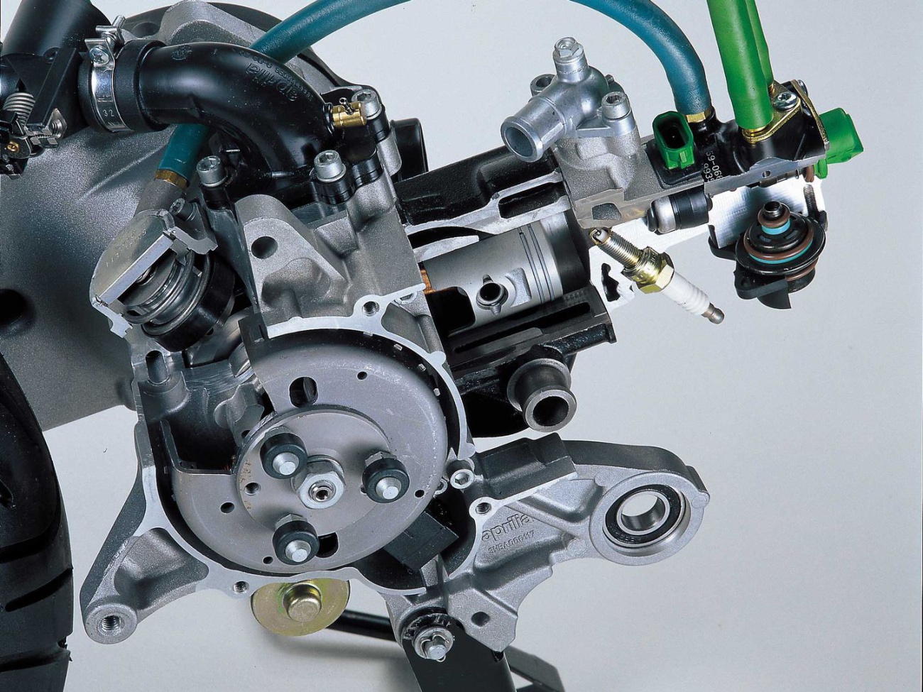

I mean I've done it both ways on the VW 888, reuse seals, install new seals, results were the same, except with the hassle of installing new seals. The SST in the brz/86 manual are kinda interesting, the big disc to shrink it back down seems dumb, I learned to do it on the Aprilia DiTech like 15 years ago with a piece of hose and a hose clamp. It gently, softly and uniformly clamps down on the seal to shring it back onto the groove. The Aprilia injector was an absolute pain in the butt, one teflon ring and 4 o-rings all had to be perfect or that crap would not even start, and you're working that thing down in the body of a scooter.
