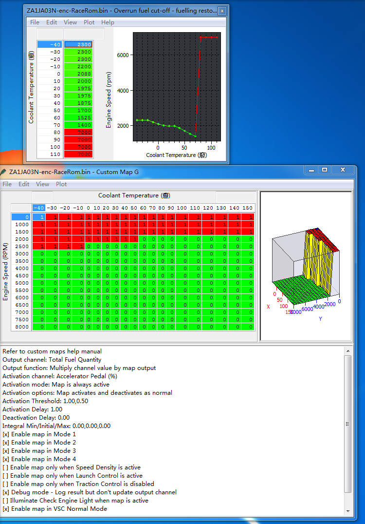

Thanks, am I doing this right? Can I customize the overrun fuel cutoff like this?

you dont need the custom map it will likely cause weird issues with idle when the ecu transitions from overun to idle mode you ill likely over fuel it if you use the custom map.
all you need to do is change the standard overun fuel resume table, maybe dont male it 7000, 4000 is likey enough, assume your just trying to create some pops and bangs ?
you can do that with just ignition retard in base timing at low loads
