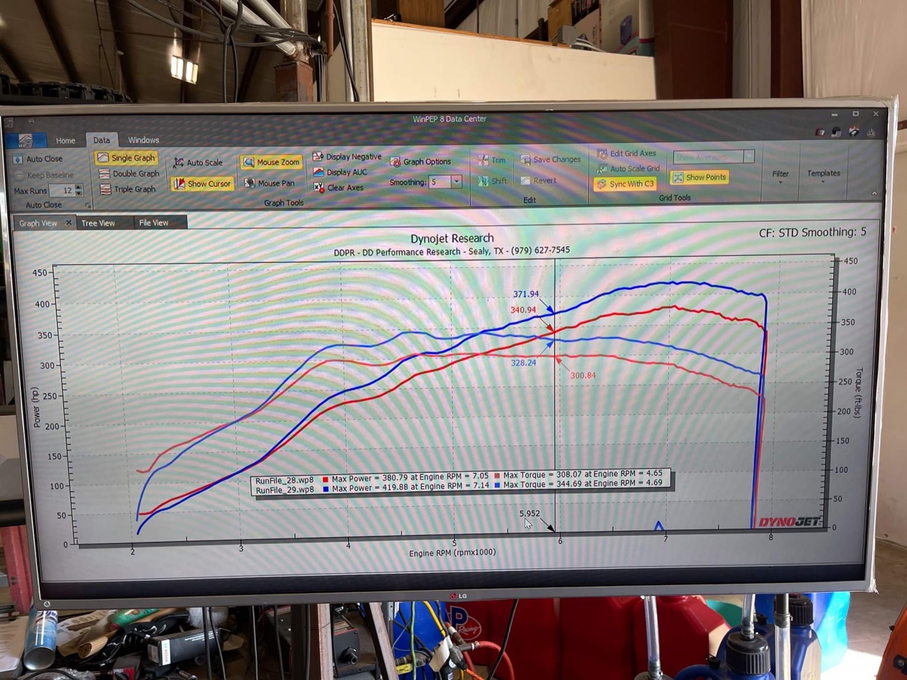

I got it. Built Block. Head work. +1 Intake and Exhaust.
GTX2867R Gen 2. 18.5 Pounds. 420WHP On a Dynojet 93OCT.

Originally Posted by 86TOYO2k17 View Post
Have a dyno? Build thread?
No build thread. But here it is.
JOSEC is offline   Reply With Quote
Attachment 210102
Nice power.
What was the change from red to blue?
Nice power.
2 different Maps.
Map 1, Red Line is gate pressure at 17 PSI. 380WHP I think somewhere around 320 TQ.
Blue is Map 2, 18.5PSI More timing. 420 WHP. 347 TQ.
Both gets on boost 3-3.5K. Lots of response, very linear power.
It’s my track car, so there was more power with more aggressive timing. But wanted to keep it more conservative.
