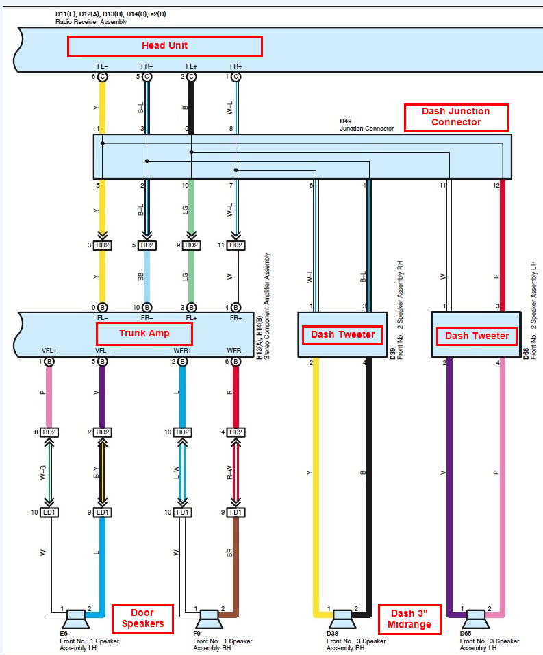

The following diagram shows how the dash and door speakers are wired. The dash tweeter and mid-range speakers are both 4 ohms. These two speakers are also essentially wired in parallel with the input to the trunk amp. Together, this presents a 2 ohm load to the HU (assuming the input impedance of the trunk amp is somewhat higher than 4 ohms - which is likely). So, the HU front speaker outputs are driving all six speakers with an amp between the head unit and the door speakers. This means that with factory wiring, whatever adjustments (tone, balance, delay, etc.) that you apply to the front HU output will be applied to all six speakers (Not ideal). If you want to deal with the dash and door speakers individually the best approach would be to run new wiring from the HU to the doors thus bypassing the factory amp in the trunk (FYI: Running new door wires is a bit of a challenge).
The rear side panel speakers are driven separately, directly from the HU and are identical to the dash midrange units with two exceptions:
1. The mounting brackets.
2. The fronts have an additional low-pass filter capacitor to block the high frequencies that the tweeters should handle.
(Thanks to @MugsBRZ for the speaker pictures.)
