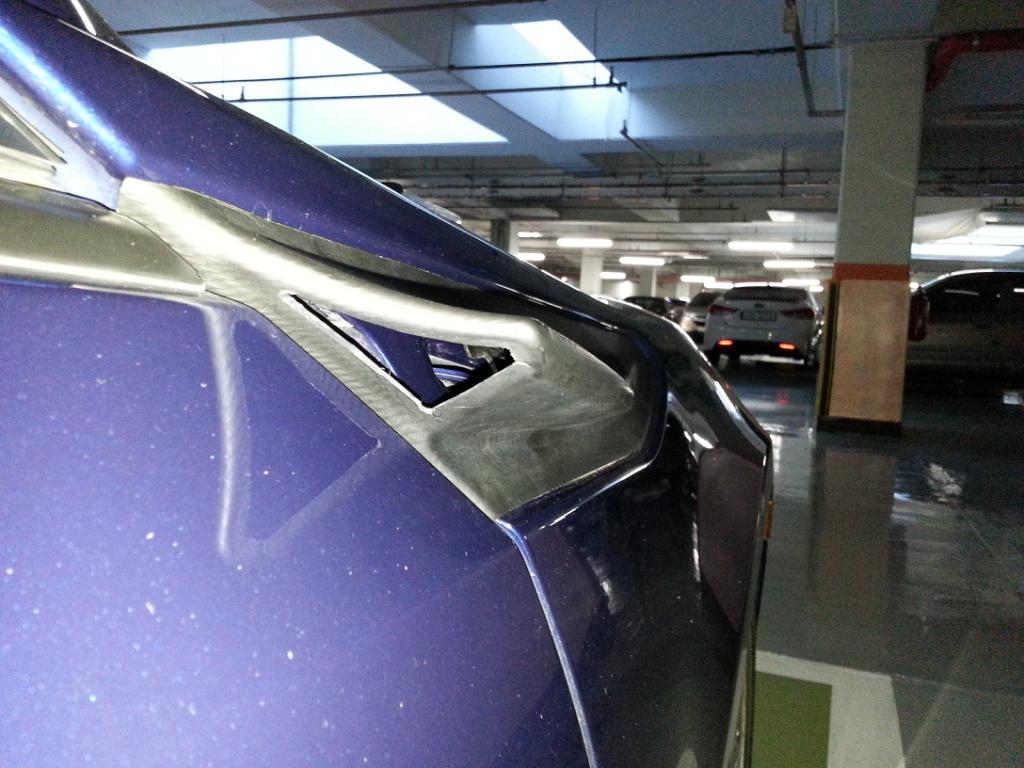

Originally Posted by avishenoy1 View Post
Wow, so I actually had this exact same idea before I stumbled upon this thread. Based on my limited knowledge of aerodynamics, I figured that the TRD fin would create a low pressure region in it's wake allowing for efficient venting of high pressure air in the engine bay if the rear facing section were cut open. I am planning to do this on my car in the near future and will attempt to do some testing of functionality with tufts.
My concern about this design however is that the air exiting the fin will hit the side view mirrors and potentially cause a significant increase in drag.
Can anyone else comment on this? I'd love to see some CFD testing on how the fin actually affects airflow on the car.
Like this? (knock off for peace of mind )
At least no bad effect measured by intake air temparature or coolant temparature.
makinen is offline   Reply With Quote
