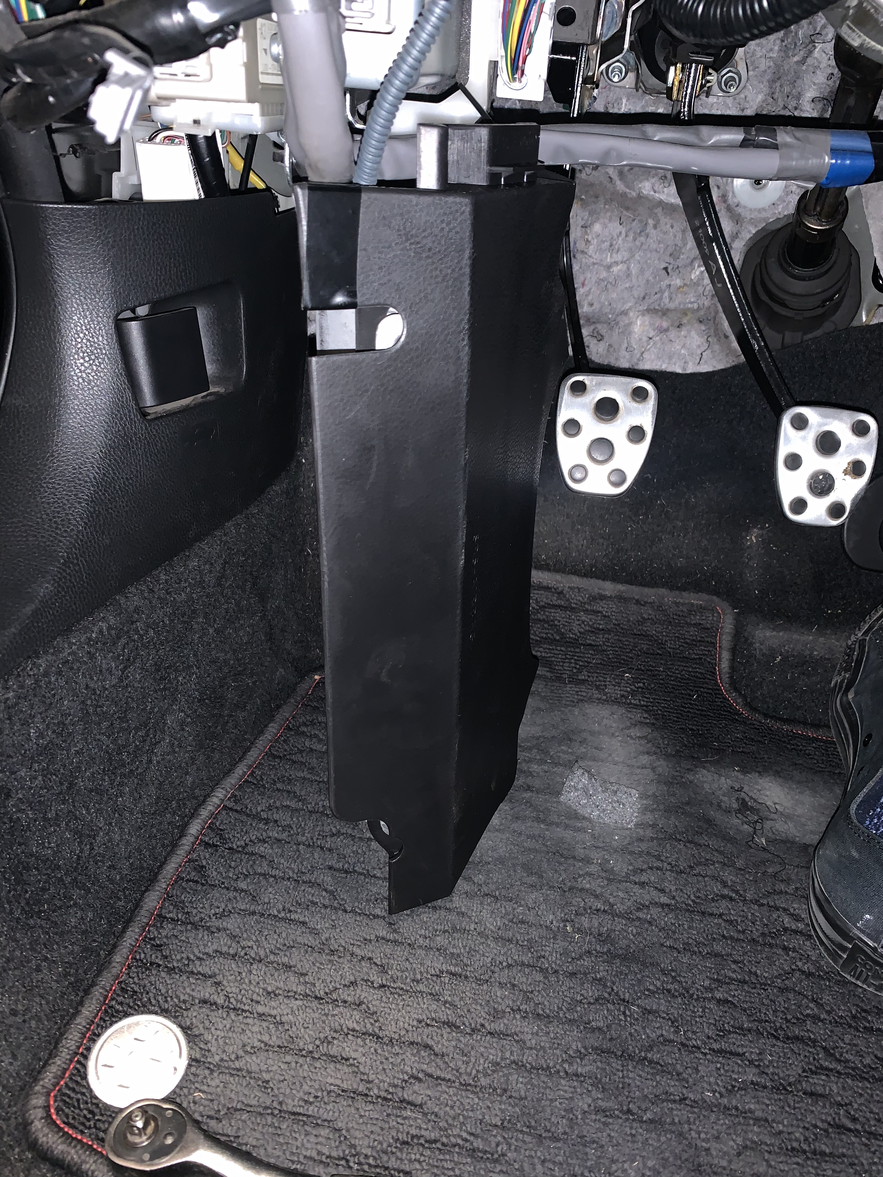

Hello all I am following the instructions but I have some questions please help.
Do I have to remove the 2 black bolts as circled in the picture behine the brake switch ??
The only 2 bolts I see are behind the steering wheel
Very confused
Okay I am up to that behind the steering flange bolt but tried everything it won't come out and my brackets are wide open. Please help not able to get that bolt out and bracket are wide and the bolt won't go in and now I have that bolt half out tried clamping it but bolt won't go in the nut help it's worse than before
