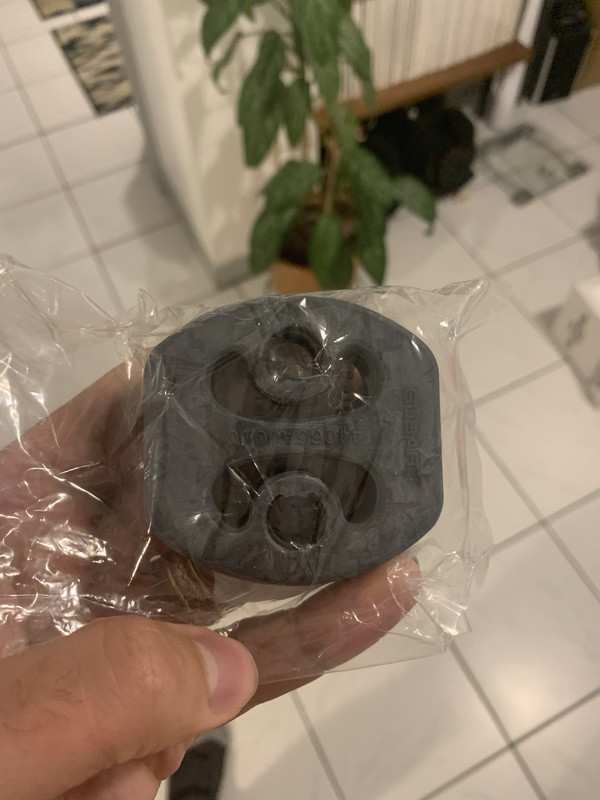

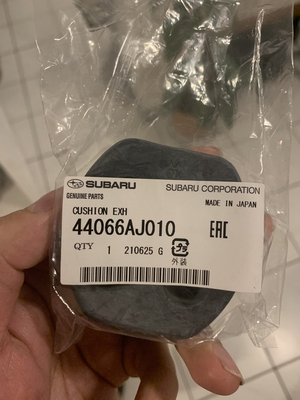

I use the Subaru JDM hangers which I got from Blackhawkjapan
Haven't heard much about the Perrin hangers but they're also available
Those look beefy. I'm intrigued...
they feel just as beefy as the stock ones, but the thing in the middle does a good job of absorbing vibrations and reducing drone being telegraphed to the cabin. Noticeable difference. I replaced all 5
