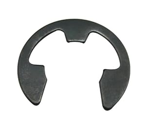

I wanted to bring this up since it has happened on multiple occasions now. Once I switched to R-comps (NT01s), I have had the entire OEM muffler assembly fall off 3 times at 2 different tracks; it literally pops off the hangers and falls onto the ground during high G load cornering, dragging down the track.
So a few months ago I didn't have time to swap the muffler off for the muffler delete before a track event at Sebring, and first session out a few laps in the entire assembly falls onto the ground during cornering and trashed the midpipe. That was the first time I had the stock muffler on when running R-comps (215 NT01s). Luckily the safety crew helped me put it back up so I could drive back to the pits. So I put the muffler delete on at the track and ran fine the rest of the day.
Fast forward to this weekend, I just had a RevWorks UEL header installed, and am running a cat delete, so I ran the first day at Road Atlanta with the muffler delete, and it was just too loud. So I swapped back to the OEM muffler, made sure there was no lubricant on any surface, triple checked it was secure, wiggled back and forth really hard and couldnt get it to pop off at all. So the first session out, 3 laps in at Turn 6 I heard it fell off. Safety crew arrived, and the OEM hangers were still on the muffler, so I went to touch them and they were a lot softer than they were when I initially installed the muffler, and we were able to re-hang the muffler back on with ease, as the metal brackets slipped in with ease.
After we brought it back into the pits, we installed C clips ( like this: http://ecx.images-amazon.com/images/...vL._SX300_.jpg ) in front of every hanger to prevent it from poping off, and ran 2 more sessions with no more issues.
So the issue boils down to the combination of the super heavy OEM muffler, increased cornering load with the R-comps, as well as the OEM exhaust hangers stretching more than they should when hot, allowing the muffler to slip off. Next up are Polyurethane exhaust hangers, and we'll still install the C-clips behind them for good measure.
Just a heads up to anyone else who is going to be running a OEM muffler with R-comps.
