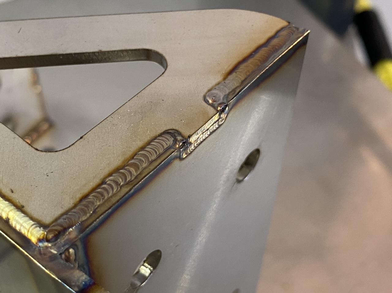

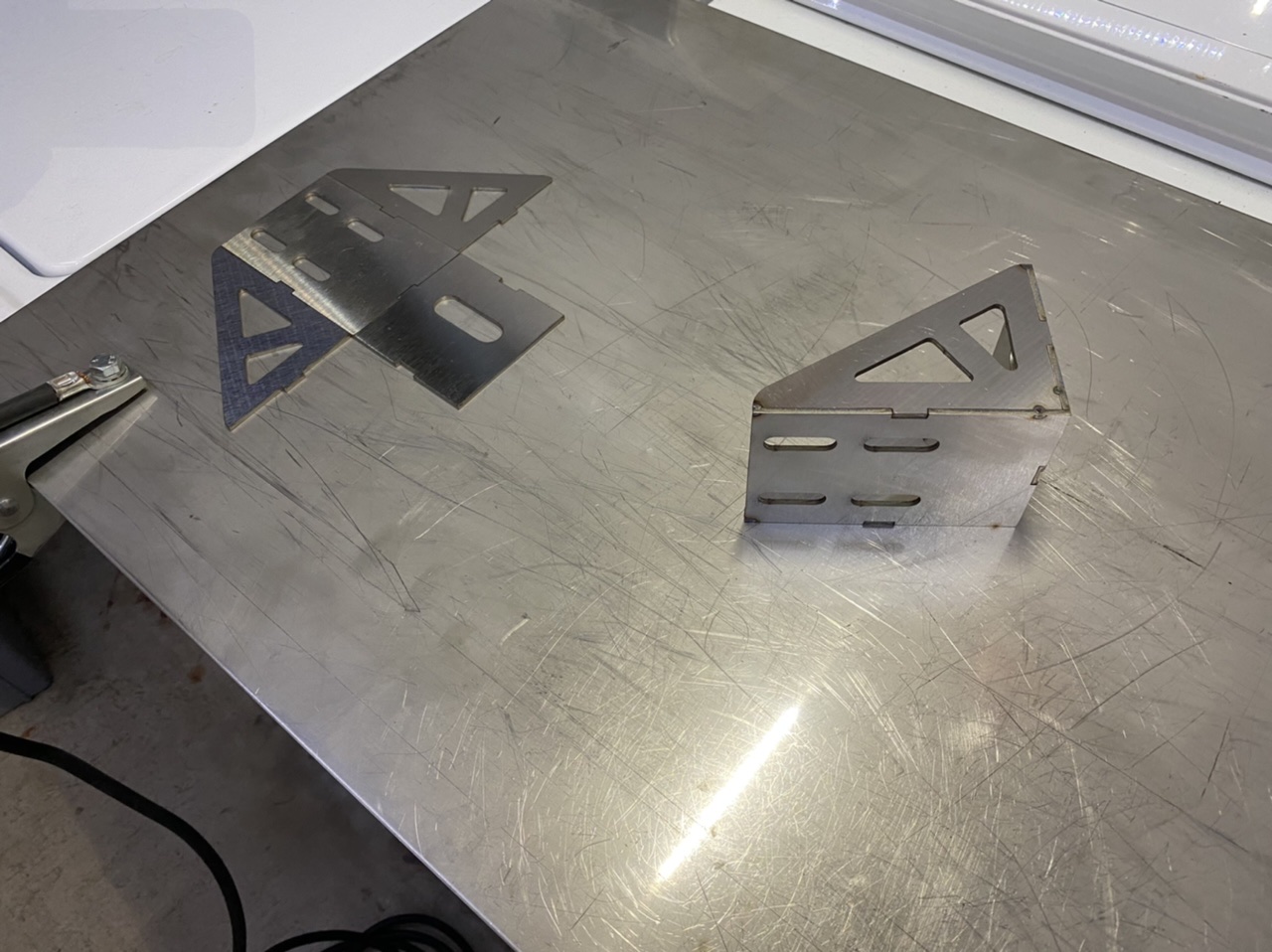

Next step, mounting frame rails.

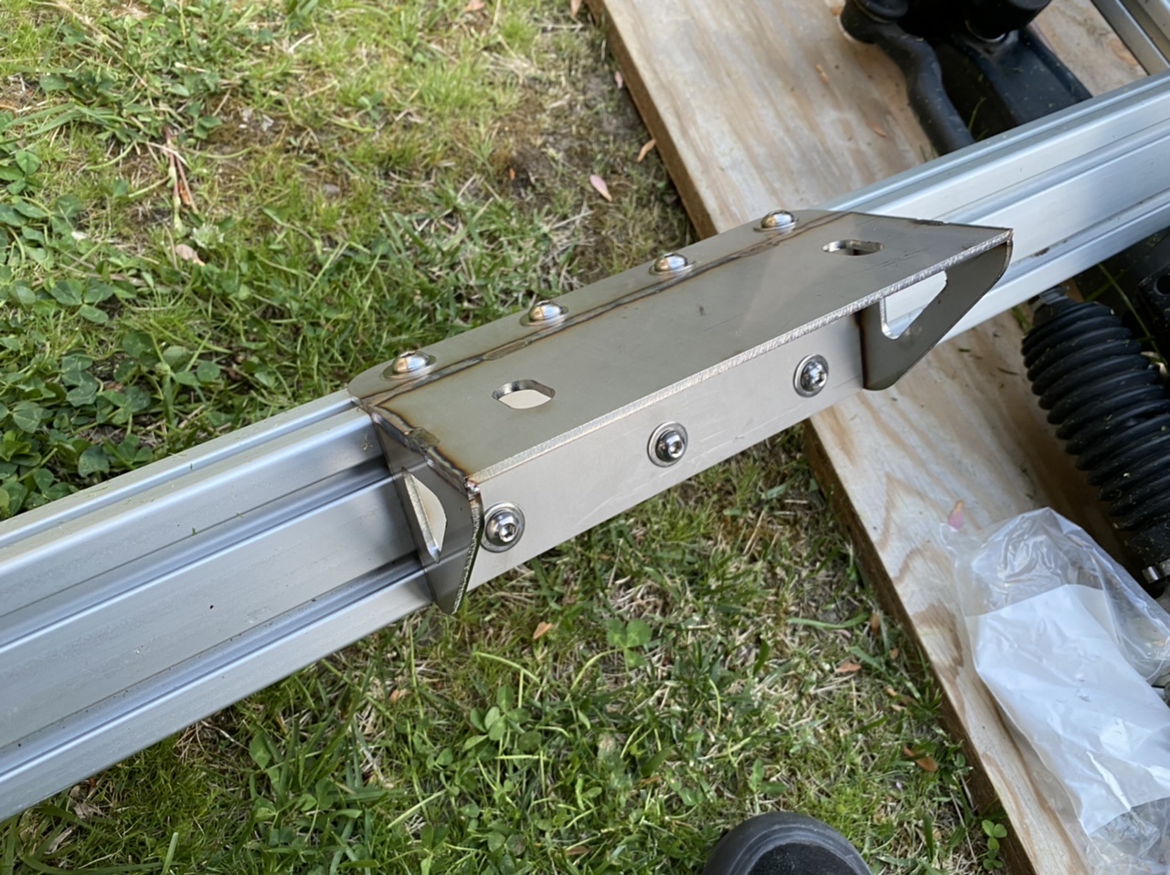

I’m a big fan of T-slotted framing for prototyping structures, especially if I’m expecting adjustments after assembly. I had a job at one point making things exclusively out of the Bosch Rexroth branded version of this stuff. The only downside is raw material cost, but i decided it was worth the saved time.
So adapting the BRZ subframe holes, that normally have big M14x1.5 bolts going through, to the 1.5”x3.0” profile with slots for 5/16-18 fasteners.
Layout, measure, CAD, laser cut, quick fit check, weld, and final fit check.
Definitely relearned how much stainless likes to warp. I should probably look into better gas coverage, too much color.
Oh, and found out the control arm bolts are also M14x1.5 and fit great in this case for mounting the extrusion-to-subframe adapters, so I ordered more of those from my local parts department. The normal bolts used for mounting are monstrously long.

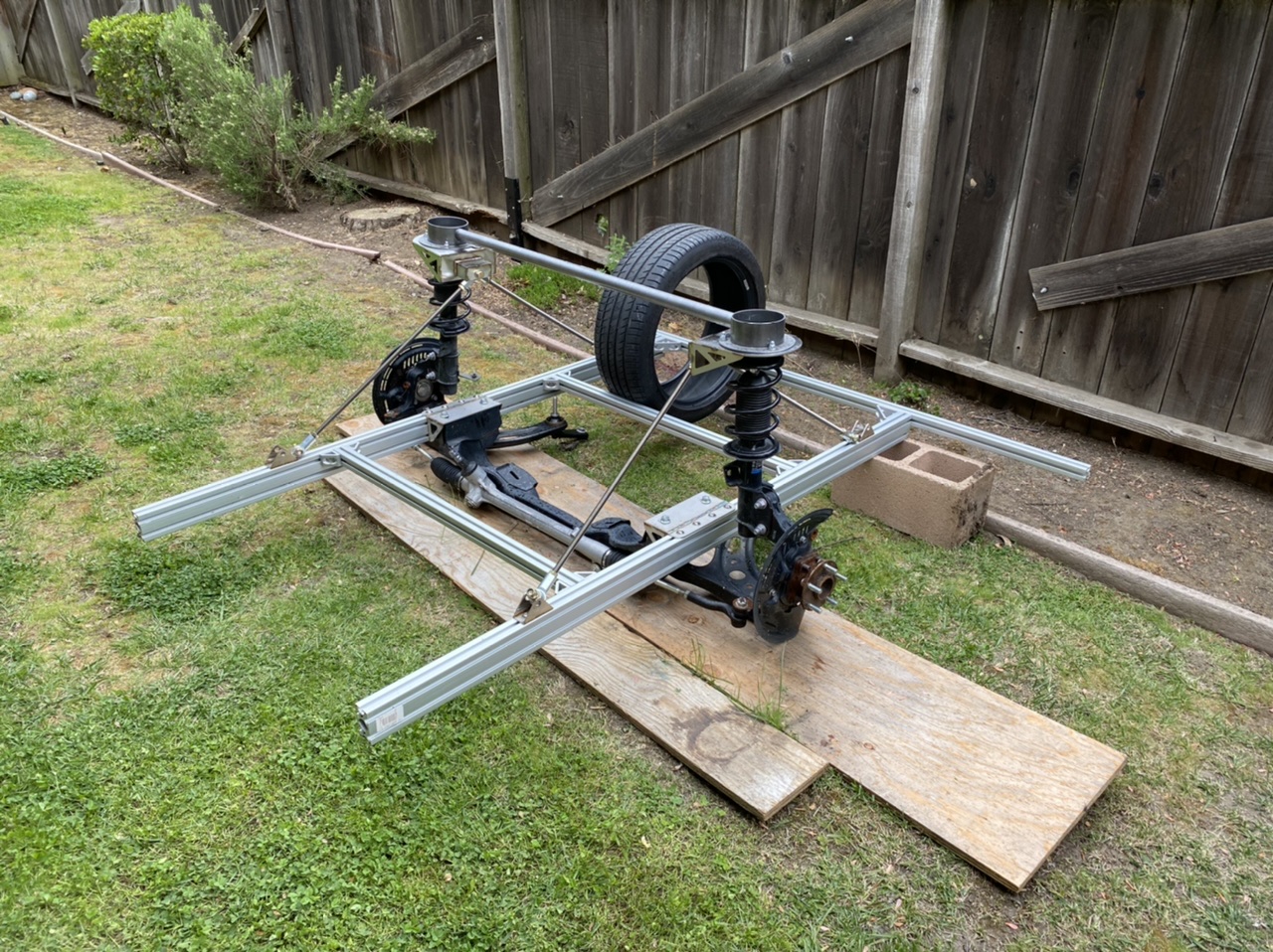

And like that, I had something that looked like a trailer!

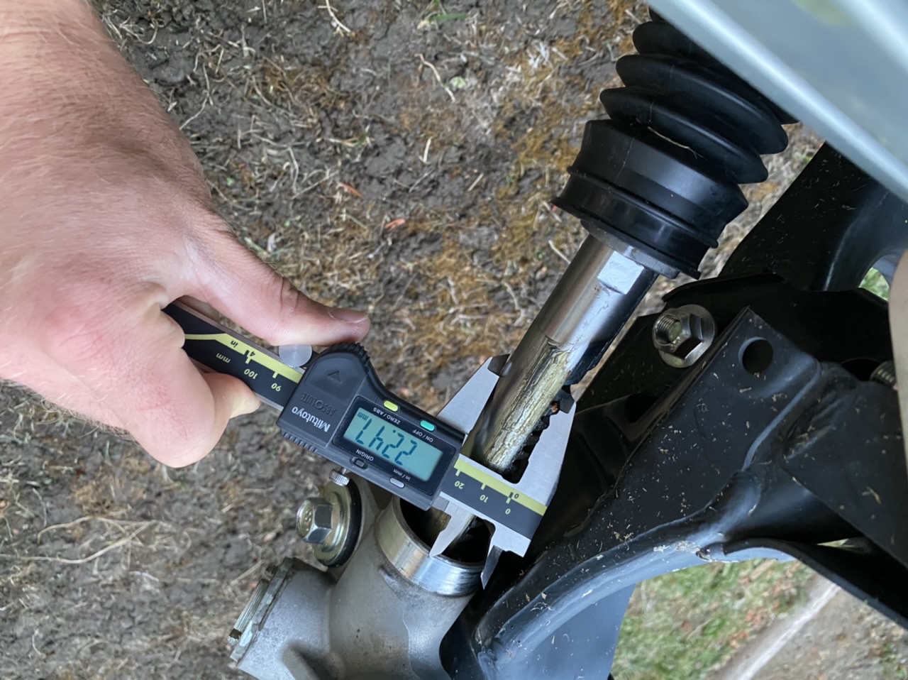

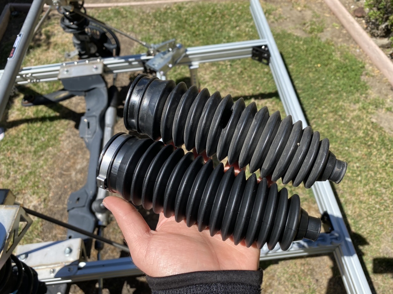

I was stricken with an idea, to lock the steering, just use oversized steering rack limiters! So much easier than what I preciously had planned. I also have a template for making 3D printed steering rack limiters now.
Also, new steering rack bellow and instead of the overpriced OEM hose clamps, got stainless single ear clamps from McMaster-Carr for like 1/10th the price. Oetiker 515 or McMaster-Carr 5435K44.

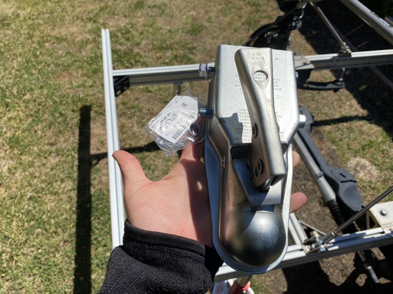

OEM nut (normally used on I think the rear suspension strut mounts) and JIS flanged bolts to hold the trailer hitch to the framing.
mkodama is offline   Reply With Quote

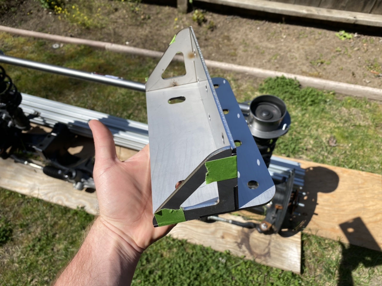

Front mounts for front control arm bushings, made in the typical CAD, laser cut, weld method.

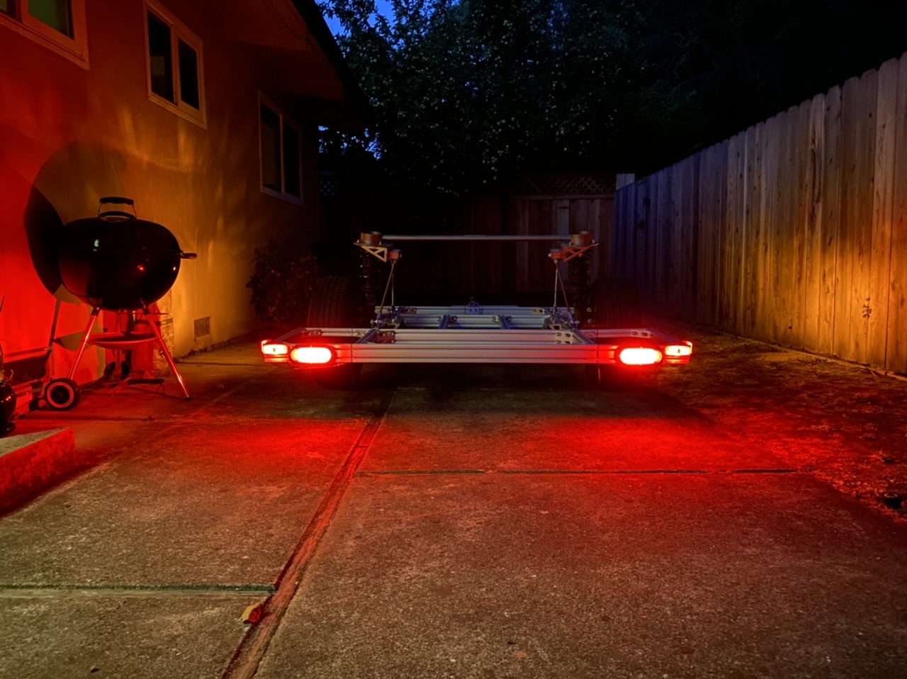

Did a little more research on lighting. Super useful resource on how trucks and trailers should be marked with both reflectors and lighting: https://www.grote.com/fmvss/
Also i realized I was missing reflectors, so I modified my setup a little. I found some tail lights that look kinda like 2017+ tail lights!
Etrailer.com was great to deal with unlike a previous poor experience with southwestwheel.com.
Lighting list:
2x Optronics STL1211RFHPG - combination tail, brake, signal, reverse light
4x Optronics MCL44RB1 - combination red reflector and illuminated marker
2x Optronics MCL44AB - combination amber reflector and illuminated marker

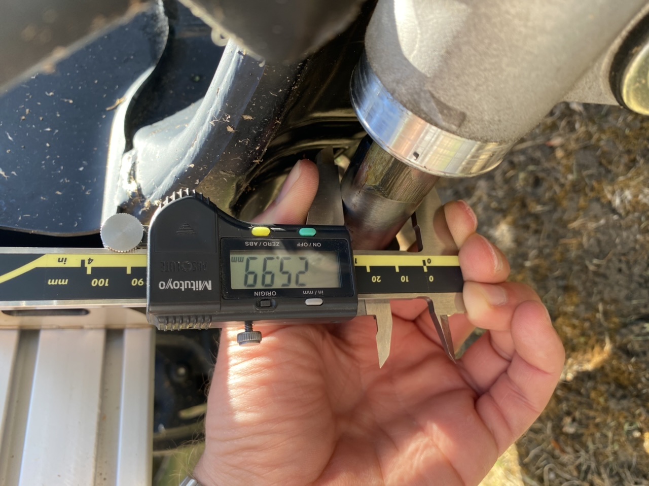

As usually, measures stuff, made a 3D printed adapter, and got the tail lights to fit on the framing.

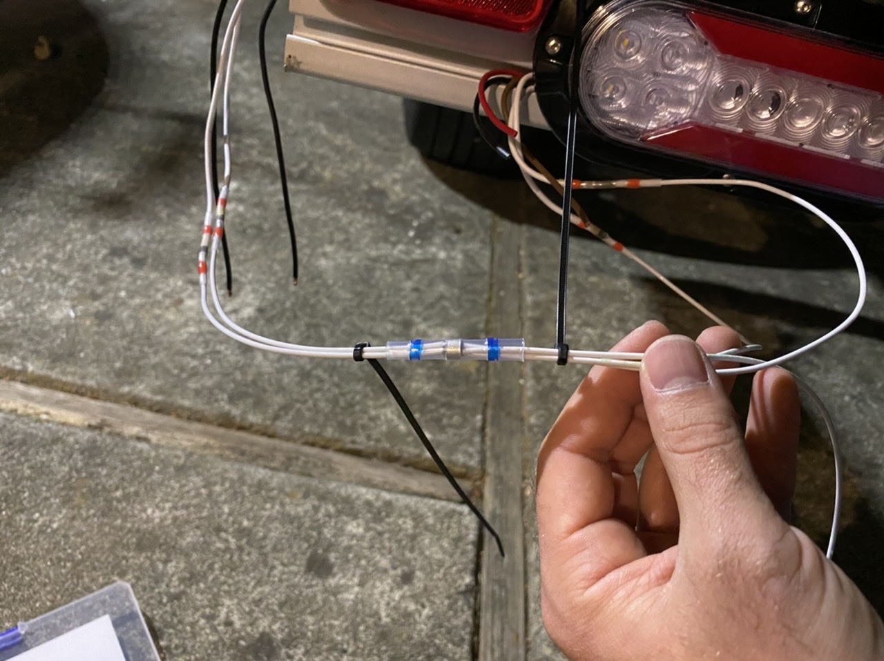

Alright! Lighting is working! Also first time using heat shrink solder splices, and even for cheap stuff off Amazon they work great!
