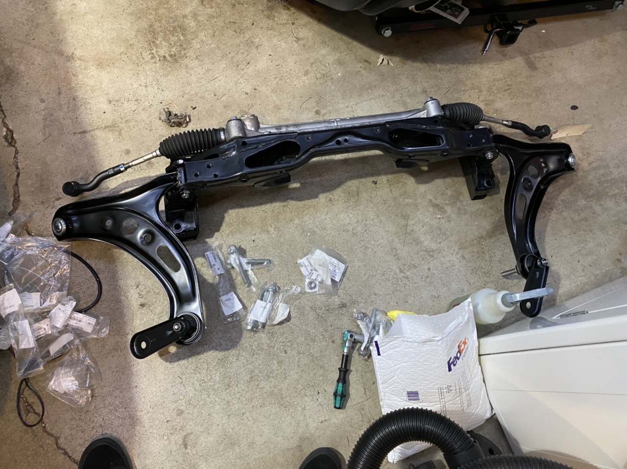

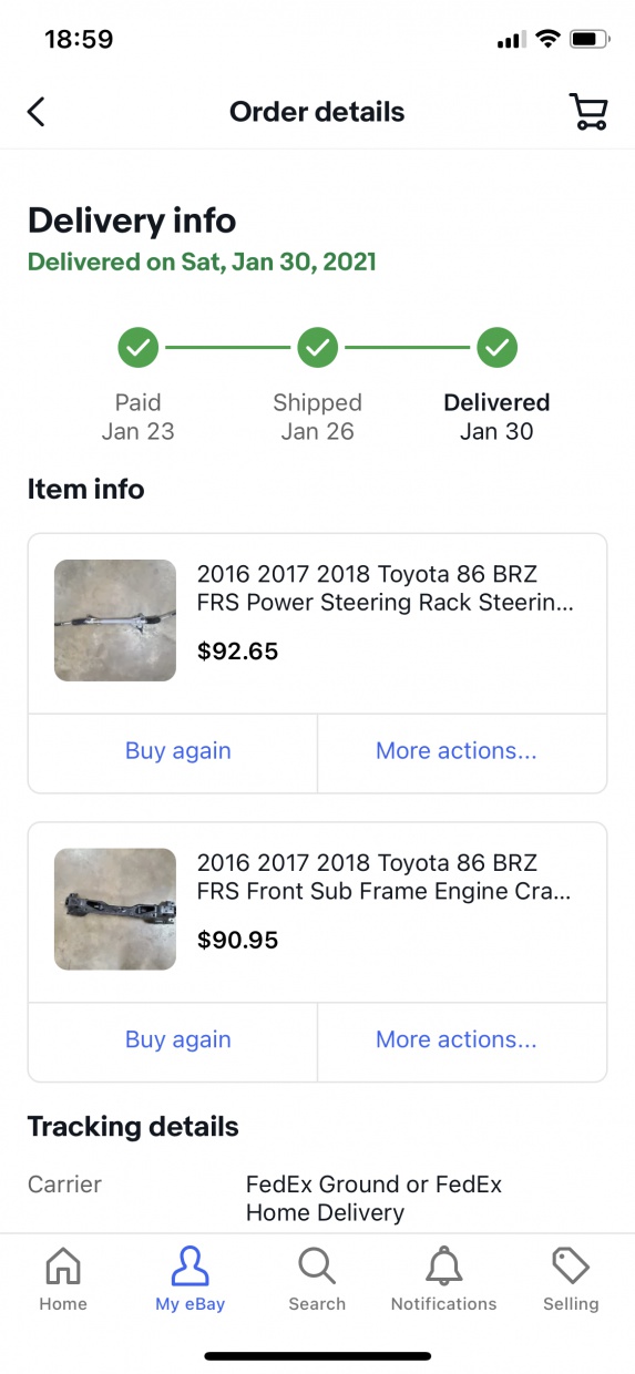

After a little bit of research and thinking, I just started ordering parts. I was traveling a lot for work at this time so all I could really do was order stuff.
  • Practically new performance package wheels and tires from facebook marketplace. Not cheap but these were practically new, and performance package wheels are significantly harder to find. Also made a new friend buying these wheels! $700
  • The cheapest strut bar I could find on eBay that supported the entire strut mount and had no hinges. This would keep the top of the struts in the right place and handle some of the loads without the chassis. $70.28
  • Two spindles from a low mileage 86 on eBay. There were cheaper out there but the low mileage part and that they were from the same car and seller seemed nice. $174.78
  • An 86 steering rack and front subframe from eBay. The fact that a used steering rack is under $100 was amazing to me. The steering rack also mounted to the front subframe to which I already needed to hold the control arms in place. $200.58
  • I couldn’t find control arms on eBay that didn’t look bent, so I bought the cheapest I could find online from a website called Parts Geek. I don’t think I would trust these on my car, but for a trailer, sure. (They are already rusting they are so crappy) $103.69
  • And like $100 of fasteners from https://www.subarupartwholesale.com/

All the parts arrived and I started putting things together on my garage floor. Assembling the front suspension outside of the car is amazingly fast and easy. Now a have a floppy semblance of an axle.

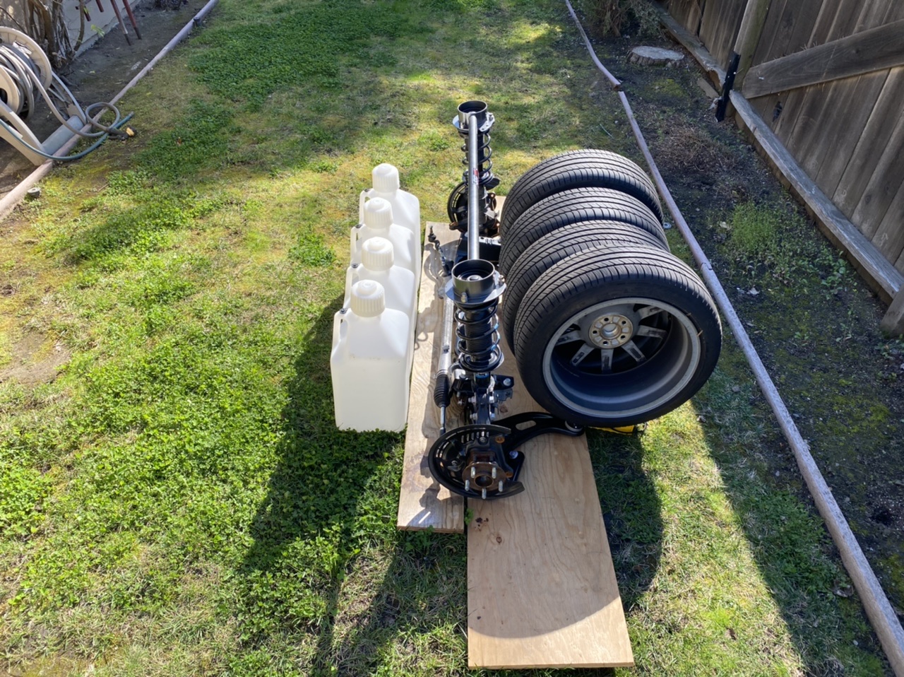

Trailer balance has definitely been a big thing on my mind. I’m leaning towards tires on the car side of the trailer axle, so that there is always weight on the trailer hitch for safety. Tools may vary, fuel jugs get used up, but wheels and tires are a constant.
My track wheels and tires are 44lbs each
the track wheels are about 2 feet from the trailer axle and 4 feet from the hitch
59lbs on the hitch with just wheels on the trailer
0lbs on the hitch with 20 gallons of gas and 50lbs of tool on the opposite side of the axle of the wheels.

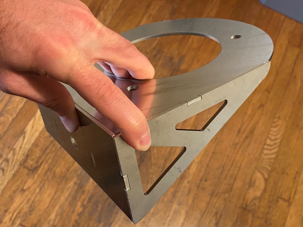

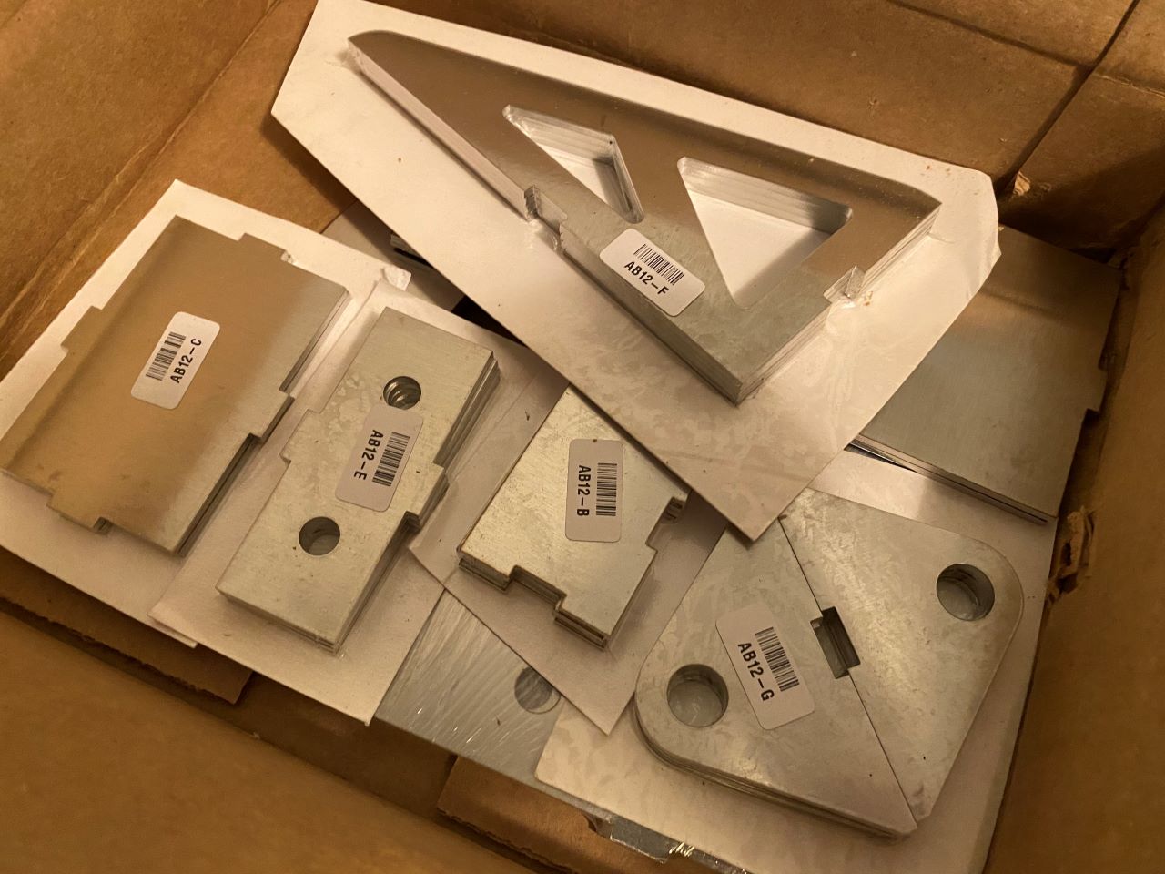

Next on the list was to make something to replace the strut tower. I needed something to control just ride height, and caster angle, since camber is controlled by the strut bar and steering by the steering rack. I looked into buying sheet metal, but it seemed a bit restrictive and not rigid enough unless ALL the sheet metal was present.
So I decided to make this my first project designing something with spherical bearing rod ends. They would take care of some of the weird angles so that I don't have to measure them. They would connect to some threaded rod, and the other end would have a mount that attached to the T-slotted aluminum framing I planned on prototyping with. Added bonus would be tons of adjustability to change ride height and caster.
Added bonus picture at the end; you get to see my silly dryer-top TIG welding setup because I don't have much space. Aside from the lack of kneed room and uncomfortable chair, it worked pretty well!
  1. Plan out manufacturing techniques; laser cut stainless and welding is super affordable, easy for me to assemble since I have a welding machine, and stainless so no need to worry about corrosion while it's sitting outside.
  2. Figure out important dimensions and measure them. Get dimensions of pre-manufactured parts, which in this case were the rod ends, bolts, and nuts from McMaster-Carr. I hate mixing metric and inch, BUT using inch products gives me more options and better pricing. I decided to go a bit overkill and use 1/2" grade 8 cadmium plated hardware, because it barely cost anything extra.
  3. Model it up!
  4. Send part files out for laser cutting. I've been loving https://www.oshcut.com/ for instant quotes and the quality of their work.
  5. Check dimensions of incoming parts. I didn't have a picture of me test fitting just the laser cut plate on the top of the strut.
  6. Weld!
  7. Check to see if the part actually works and you didn't just waste a bunch of time and money. (Pictures of fitment in a follow up post)
mkodama is offline   Reply With Quote
