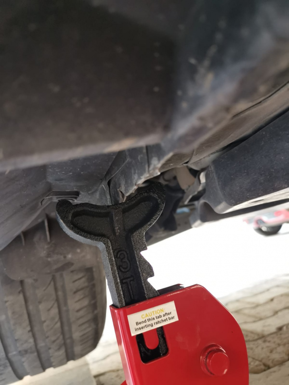

Alright so I jacked it up and this is how I put the stands:
If I be honest it still doesn't make sense to me how thin metal is strong enough to bare forces when tightening/loosening bolts down there. Also the scissor jack that comes with the car avoids putting weight on the metal piece completely but puts it on either side. These are the only types of stands that are possible to get so idk. It did the job yesterday but just in case I stacked up bricks on both front and rear tyres, but I'm skeptical of taking the exhaust out on it, just seems to slippery?
Because of the unevenness of my driveway, there is always one jack stand that isn't holding any weight and is loose, which means you can keep your car lifted with only 3 jack stands. I keep the loose one in position anyway, just in case. The reason these stands, made of cast pot metal and weak welds, can support so much weight is because they transfer the weight to the cement. It's similar to how the pyramids of Egypt don't just collapse under their own weight, since they are somewhat hollow in the center.
Friendly reminder: read the stickers on your stands. Bend that safety tab in already.
