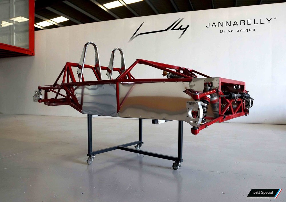

Not quite a dedicated hardtop, but this is lovely. Ticks many boxes and the price isn’t bad.
I love this thing!
The crazy thing is, though it looks like an extremely cab-rearward front-engine rear-drive car, it's mid-engine! There's actually room for its transverse V6 behind the passenger compartment!
As with the Elise/Exige, it gets its frame stiffness from having very deep and wide sills. This frame is heavily triangulated space frame of square-section steel tubing with some sheet panels. It looks to have very efficient load paths between suspension mounts. As with the Lotus, it doesn't have "normal" door openings and driver and passenger are tight against each other as they are between the wide/deep sill areas occupied by the frame structure.
Don't have figures but I'm sure it's plenty stiff for 950kg/2100 lb.
