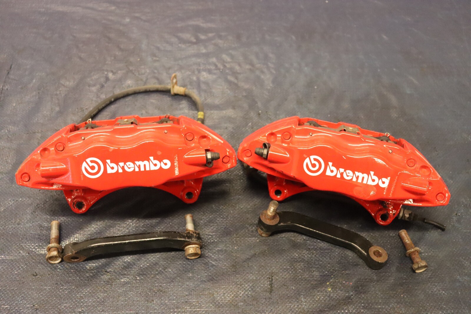

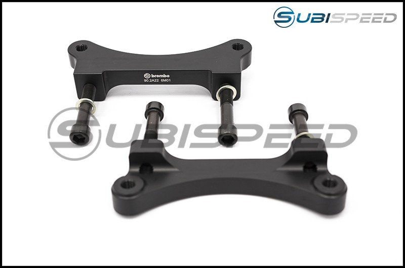

Preface this by saying that I have worked with Brembo in Italy, Continental (Teves) in Germany, and with J.Juan in Barcelona developing brake and ABS systems for 2-wheelers. Structural engineer but at this job I was also responsible for general vehicle development including brake performance.
Anyhoo...
Yeah, main reason is the moment due to pad/rotor friction acts to load up the leading edge of the pad and unload the trailing edge. You will usually balance this with a smaller-diameter leading piston to get more even pressure between pad and rotor along pad length. It's really not a huge deal though. I did notice a *slight* front-to-rear taper wear when I changed out my track pads, but very slight and of course can be fixed by swapping inside/outside pads next install.
They may tout them as "radial mounted", but how is that bracket mounted to the upright? Axial bolts. Actually this setup is marginally *less* stiff as you have an extra bolted joint (the "radial mount" part) in addition to the factory axial mount bolts.
For overall bolted-up caliper asembly stiffness, I would bet on the factory PP setup...
Besides uneven wear, there will be uneven pad contact that will reduce brake performance. I don't know by how much, but it will likely get worse and worse as the pad wears, especially if someone isn't rotating their pads like you mentioned. The STI rotors are staggered, even if they are axially mounted.
I think you mean it has an increased opportunity for flexion or failure if it wasn't secured properly. It should be stiffer. Think of it like a welded joint, which is stronger than the material it is joining, yet it has an increased opportunity for failure if poorly done. Similarly, the steel bolts running through the materials should make for a strong union. Moreover, the positioning is better, and the materials are stronger.
You will notice that the Brembo brakes on the PP use a small spacer between the caliper and the axle, which creates a smaller contact patch and a greater moment arm. These brakes appear to be cast, so the long body of the caliper creates an opportunity for deflection.
Compare that to the GT kit or the Wilwood kit. You say that the kit is axial mounted, so there is no difference, but then I would counter, what is the difference between a two piece axle versus a single piece if strength is maintained? In the case for these two kits, the bracket appears to be forged and machined, and it is fairly thick. It also centers the caliper over the rotor, and in the case of the Wilwood kit, uses protrusions that center the caliper like dowel pins. Lastly, the calipers on both of these kits are forged instead of cast, so for all of these reasons, I believe they are much stronger and more secured in position.
The Brembos on the PP are pretty bulky though, so perhaps that makes up for their shortcomings. Obviously, the bulk was necessary for some reason, and it makes for a smaller capacity for pad thickness.
Again, the point isn't to say the Brembo brakes are terrible. They are an upgrade, but there are aftermarket ones that are an upgrade from them for a similar investment for some. If you can do the labor like myself and sell your old brakes, the price is pretty good for what you can get. Regardless, the point of all this was just to provide a different perspective that the PP may not be the deal of the century. I'm glad that people are happy with their purchase, and I am not trying to change that, but it is healthy to have a realistic perspective on the situation--just saying.
Pad contact will be maintained across the pad, there'll just be a bit less pressure at the front of the pad vs. rear. No loss of braking performance, just *slightly* front-to-rear tapered wear (under hard track usage) as the front of the pad is applied to the rotor with slightly greater pressure.
It really isn't that big a deal... Particularly considering that the car is fairly over-braked vs its power and weight.
I'm getting *slightly* tapered front/rear pad wear. Of course it'll get "worse" but it's not a big deal. If I didn't take them out and rotate, might cost me ~10% of pad life I would estimate.
You could consider that "radial" mount portion rigid, and you'll still have the same two *axial* bolted joints connecting your brake caliper bracket to the factory upright. Hence, you aren't getting the benefit of a TRUE radial-mount caliper. You're still axially mounted, you just have an additional joint to a not particularly stiff-looking bracket design with "radially" oriented bolts.
Strong enough I'm sure, but not infinitely stiff. It's an additional bolted joint with additional flexure/compiance
How is positioning "better"? Your bracket bolts up to the upright at the factory positions. Those axial bolted joints will have the same (worse actually given the bracket design) flexure/compliance as stock.
That doesn't go between the caliper and upright, it goes behind the upright. I.e. it does not increase moment arm. Basically it increases stiffness of the upright and allows for a longer bolt so that bolt preload isn't as affected by temperature changes.
"Contact Patch", is going to effectively be a diameter of about 2x bolt diameter. But speaking of which instead of having broad beefy continuous cross-sections of material between mounts to the upright, you have an *additional* two small area bolted joints with the Wilwood and aftermarket Brembo GT calipers. Less stiff, more flexure. Of course they're made this way so they can be fitted to multiple different cars. But it *is* a design compromise that reduces stiffness.
Cast 356-T6 aluminum is as stiff (slighlty stiffer) as machined 6061-T6. 10.5 Msi vs. 10.0 Msi modulus of elasticity. That's not an issue. What is is the structural path between the mount to the upright and the caliper. The aftermarket Wilwood and Brembo GT calipers have the additional bracket and bolted joints, there's less beefy continuous contiguous aluminum cross-section between the mounts to the upright and the caliper body. They're gonna be less stiff.
See above. Forged aluminum isn't stiffer than cast. Bracket isn't that beefy really, and it has a hard 90degree "hinge" built into it. Additional bolted joints with limited effective contact area, vs factory setup which has broad continuous large-cross-sections of material.
Which factory doesn't need because it doesn't have these additional bolted joints. Factory and aftermarket will have the same positional tolerancing due to clearance at the axial mounting holes.
These are gonna be stiffness-critical designs, not strength. Cast aluminum vs. forged have the same modulus, same material stiffness. But the factory part is gonna be stiffer as-mounted for the reasons already covered.
Bigger opening = less stiffness. If you're going endurance racing you might want a wider opening and thicker pads.
Absolutely! Here, the OEM solution has some inherent advantages due to not requiring a separate bracket and additional two bolted joints between the caliper and the upright.
Is it really that big a deal? Probably not given that all of these systems are IMO massive overkill for this car at stock power. But for sure the "radial-mount" feature is not a benefit over stock when they both bolt up axially to the uprights. The "radial mount" part just keeps it from being even more of a stiffness reduction.
Honestly, the factory PP Brembo brakes are IMO massive overkill for this car at stock power. When I first learned they were going to be offered in I figured they'd be part of a $3500+ "package" and I was gonna skip it, because I know I could get pads and fluid that will work with the "base" brakes. For $1200, though, it's WELL worth it to me for:
1. ease of pad changes
2. improved braking feel
3. greater range of pad materials will work
4. less frequent fluid changes required
5. looks cool...
A bargain...
