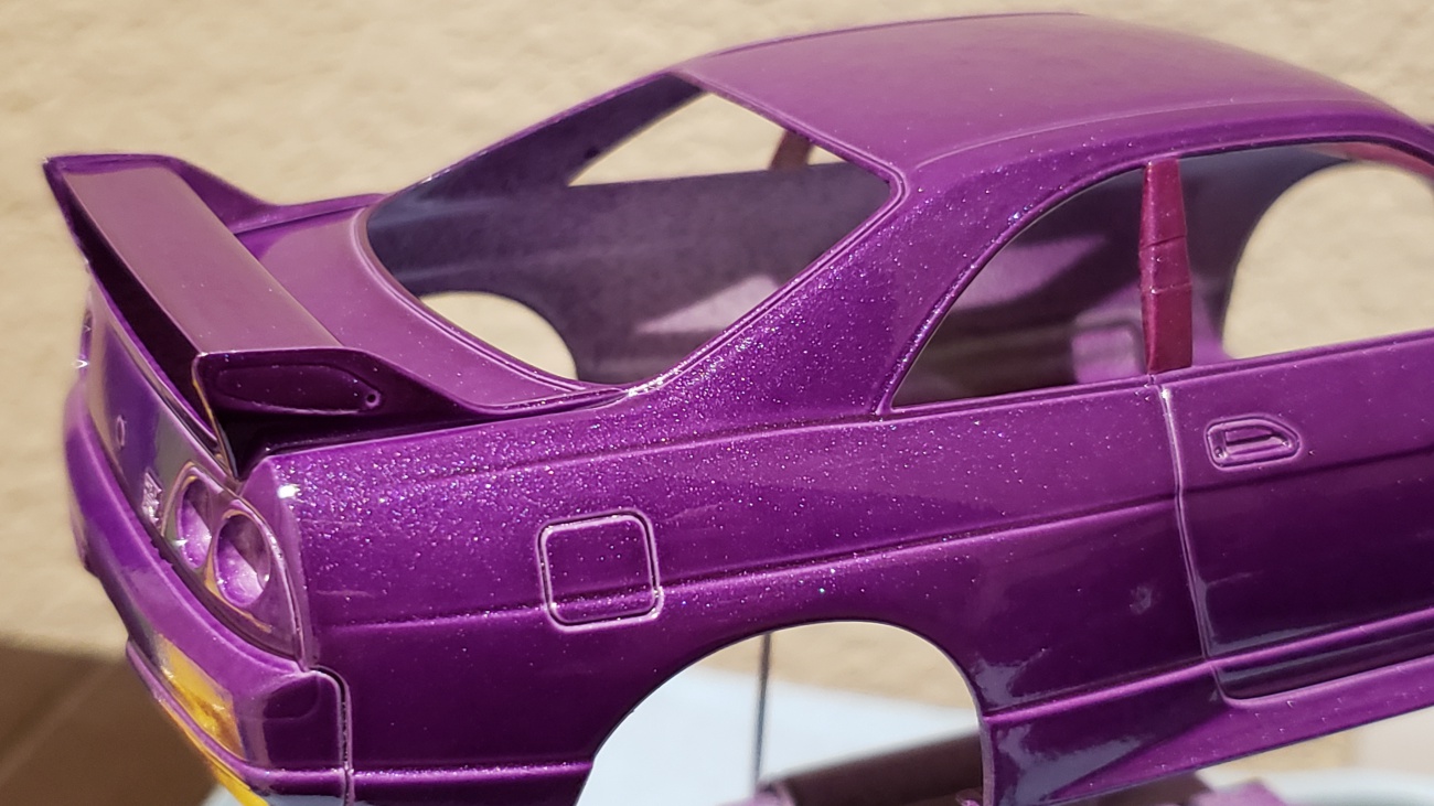

First layer of the color. Not a fan of Testors/Model Master spray paints. Might be the nozzle, but it sprays in a splatter kind of pattern. Not uniform and nice like the Tamiya spray cans. The farther I spray the can, the more splatters. So I tried a little closer with the bottom of the chassis, paint clumps together and becomes super thick.

Can get close as long as you also speed up your swing across the work piece. You have to really speed up. Takes practice to time pressing the valve.
There are limits just like there are some really shitty spray nozzles

I think I read online that that's what people complain about Testor's spray cans; that they use crappy nozzles which leads to the spraying issue that I had. I can also see this will have a lot more orange peel than the Tamiya. I still have the pearl clear coat to spray, but I'll wait a week to do that since I also read that Testor paint takes foooreeeeeeever to cure. Sucks that Tamiya doesn't do pearl purple. Well, at least now I know to avoid Testor. lol. I guess that's also why there were so many Testor cans left at the hobby shop I went to, and barely had any Tamiya cans.

So I just noticed that the Testors color I used is an enamel. I'm pretty sure the Tamiya pearl clear I plan on using is a lacquer. Does anyone know if this will be an issue?
Edit: googled it, and found mix reviews. Some people did say they just let the enamel dry for at least a week or two, and then used Tamiya clear on it by using very light coats. Looks like the R33 body won't be done for a long time since I think I have to spray another coat of the pearl grape since it doesn't adhere to edges very well (another reason why I won't ever buy Testors/Model Master again).
Edit #2: didn't want to waste my effort, plus the Tamiya pearl clear, so I went ahead and ordered a can of Model Master enamel gloss top coat. I'll just save the pearl clear for another model. Now I'm debating on if I should try spraying on another layer of the pearl grape since the edges of panels are much lighter since it doesn't seem like this paint adheres well to edges.

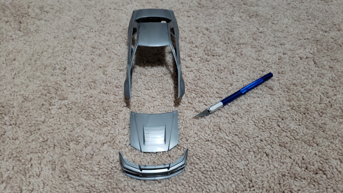

Since I can't touch the R33 due to the enamel paint still not being cured, I decided to start working on the R34. Sanded down the mold lines, and cut out the hood (much easier than the R33's hood). I think it's expected to rain starting tomorrow, so can't really do anything else to the R34. I still gotta finish scribing the panel lines though.

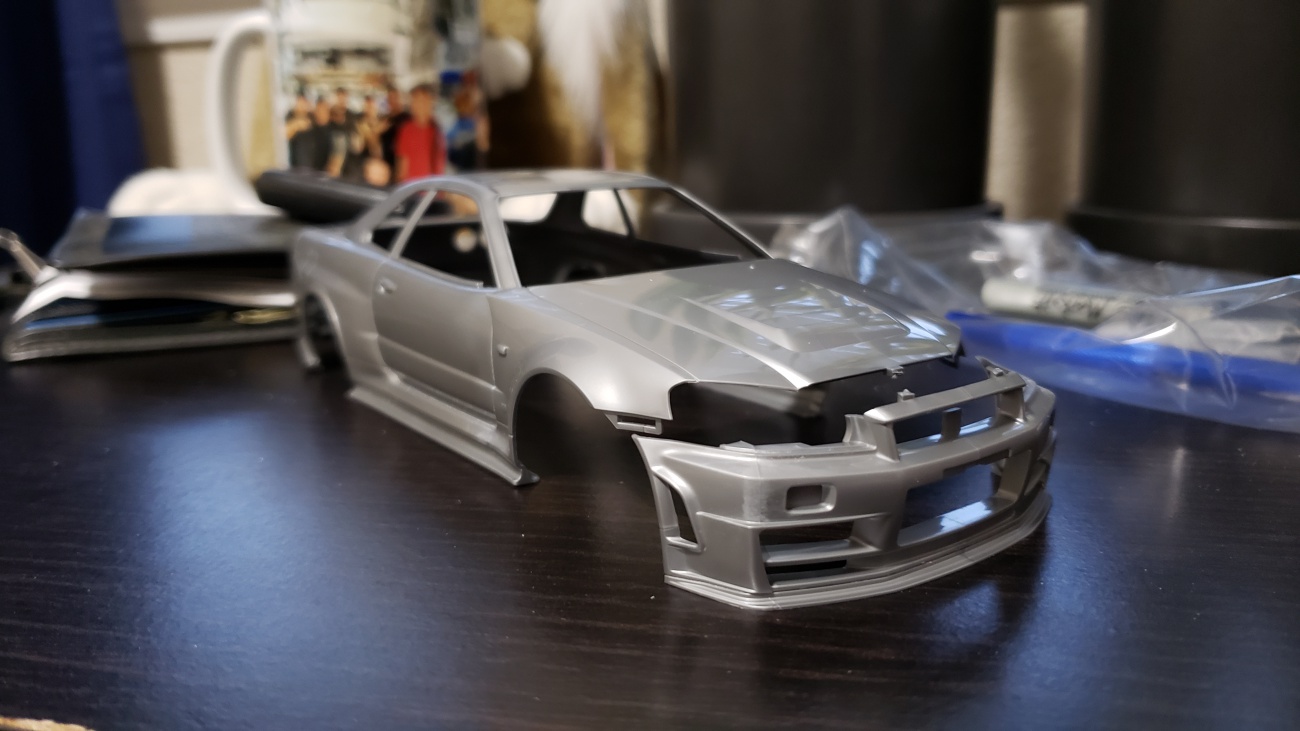

Scribing done. Put on the black accent lines. Dry fitted the spoiler and wheels to see how it will look. Can't wait to paint everything and get it done now!
