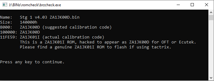

Does anyone have the OFT K01I definition? OFT's website doesn't provide them.
Compelica is offline   Reply With Quote
Old 11-18-2020, 04:29 PM   #56
elBarto
elBarto's Avatar
Drives: Toyota GT86
Location: Belgium
Posts: 456
Thanks: 88
Thanked 390 Times in 186 Posts
It's going to sound weird, but download the K00D definition.
The K00D are actual K01I, so the definition works for a 'real' K01I.
But you have to edit the definition file to make it work with the K01I rom.
Open it with a text-editor (Notepad++) and change the 2 lines that states ZA1JK00D to ZA1JK01I.
Save and open in RomRaider.
