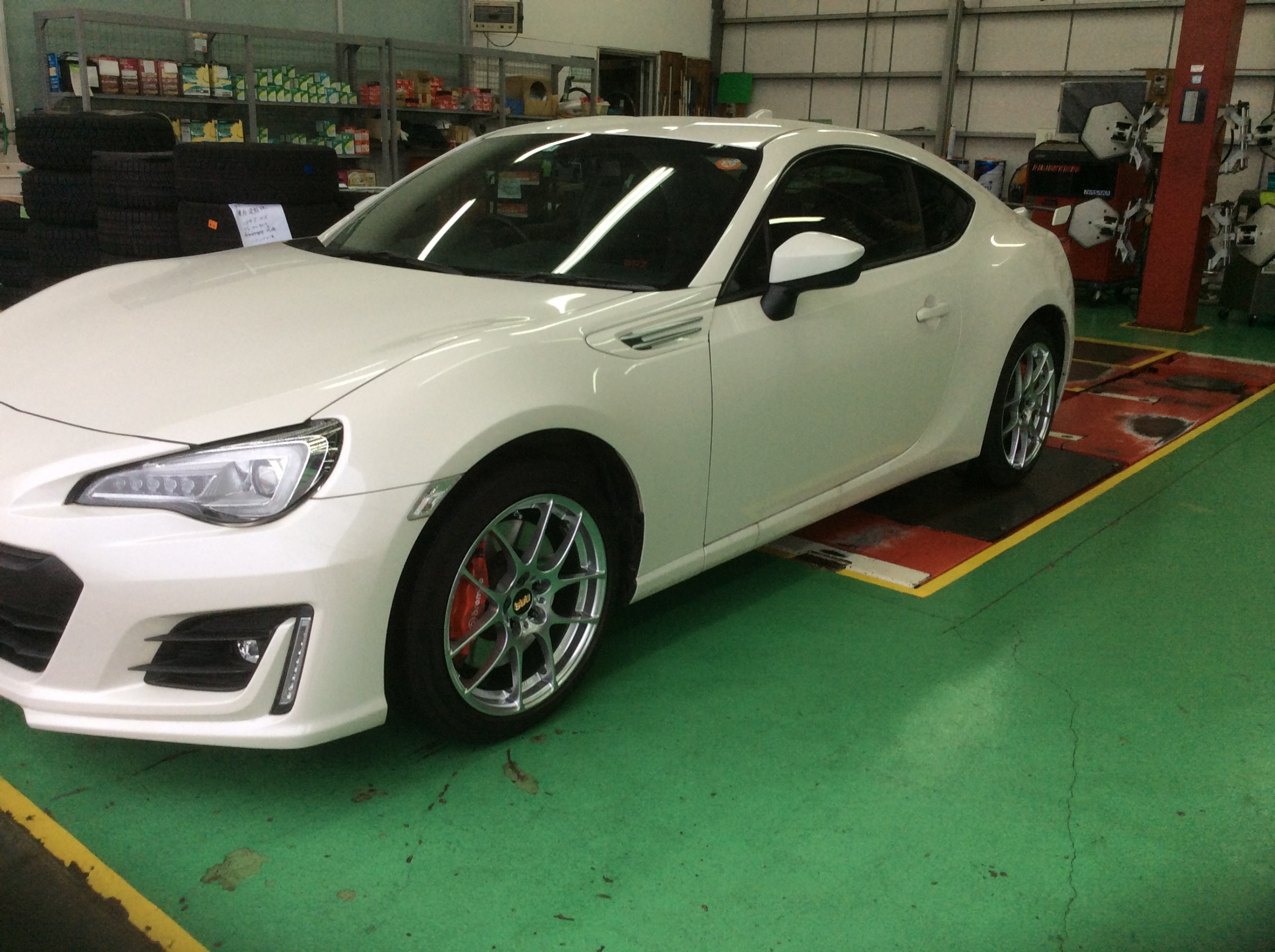

Another example showing BBS RF504 fit. Looks great.
https://www.taiyakan.co.jp/shop/mito...owcase/491234/

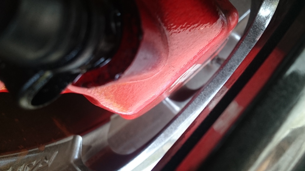

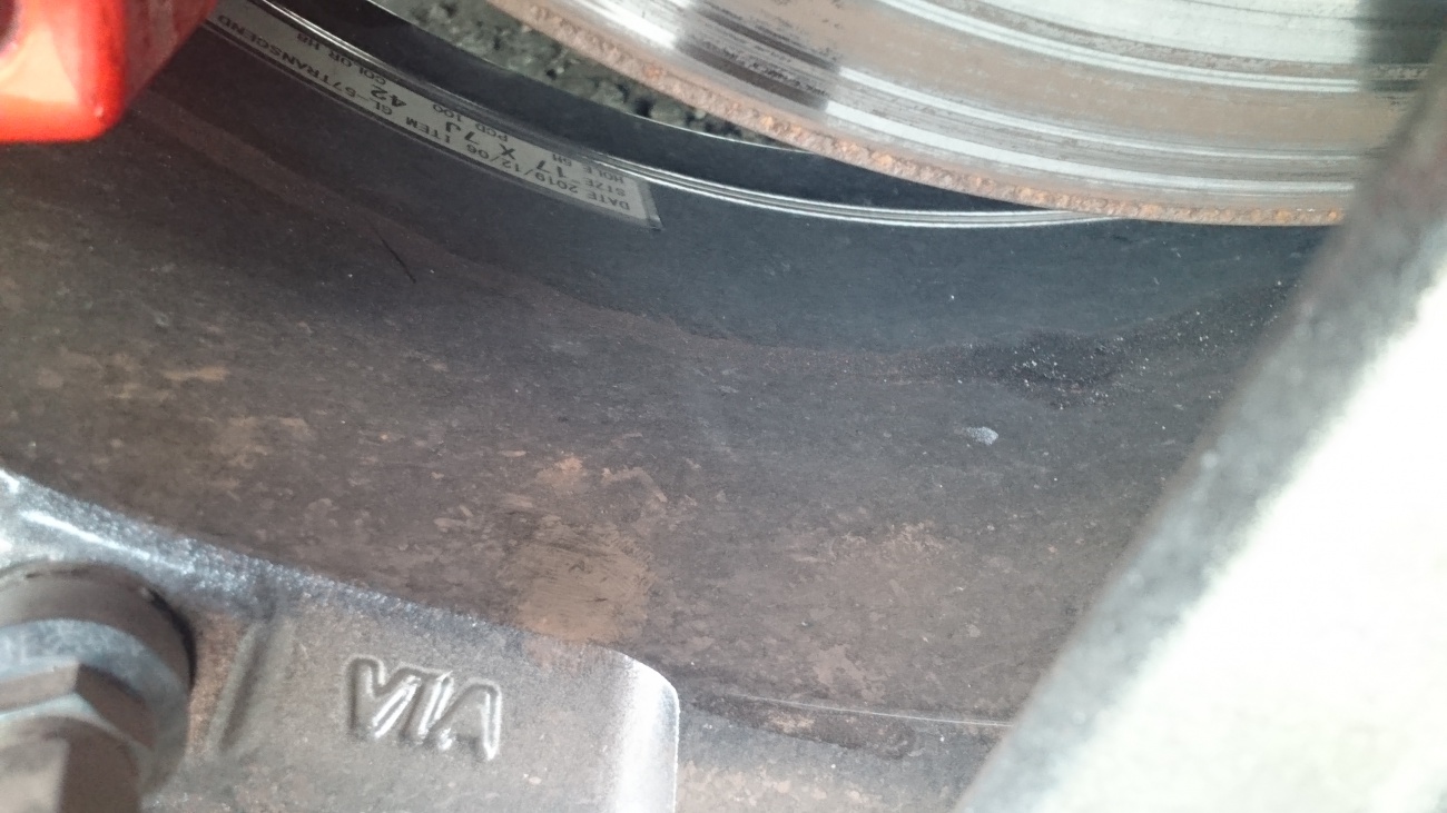

Volk CE28SL 17x7.5 +48 fits with 3-3.5mm clearance at the closest spot.

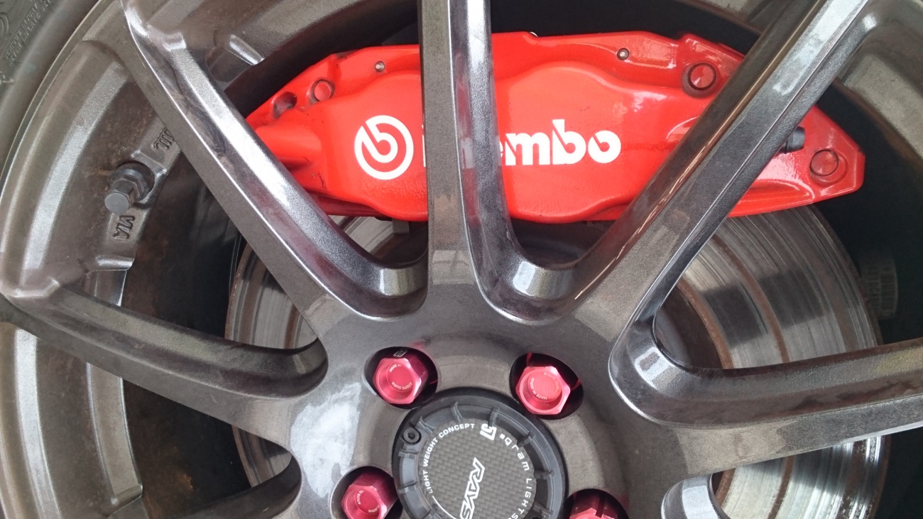

Hi, My name is Greg, I live in Scotland, here is my setup:
rays 57transcend, 17x7j et42 + 5mm hubcentric spacers all round.Name:  DSC_0013.jpg

Thanks for the info!
Do they require 5mm spacers? Or do they fit with just 3mm spacers? Without spacers?
