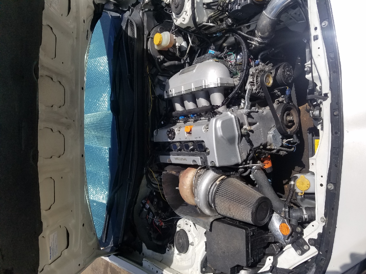

Good write up, there Scenic Driver ......thanks for posting ......
I think when my FR-S gets up to that point ..... I'll just trade it in .....
Oh, the "good old days", ...... just open the hood, climb in the engine compartment and change the plugs; a 5 minute job.....
humfrz
10 min for me!
hours to change. Before pic

Originally Posted by solidsnake11 View Post
10 min for me!
Attachment 188823
i'd call you a cheater, but that's much more setup work than a set of plugs!
