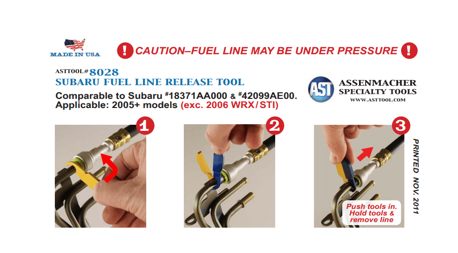

Originally Posted by knucklehead View Post
Do you or anyone know who sells this? it would be better if it would be somewhere in Canada.
I had my local snap-on truck guy grab one for me. Can't speak for in CA but, it is on Amazon. It is also included in AST's 10pc set #1018.

For removal of the fuel line and without using an actual proper fuel disconnect tool, using zipties worked extremely well. Didn't have to struggle for the disconnection.
