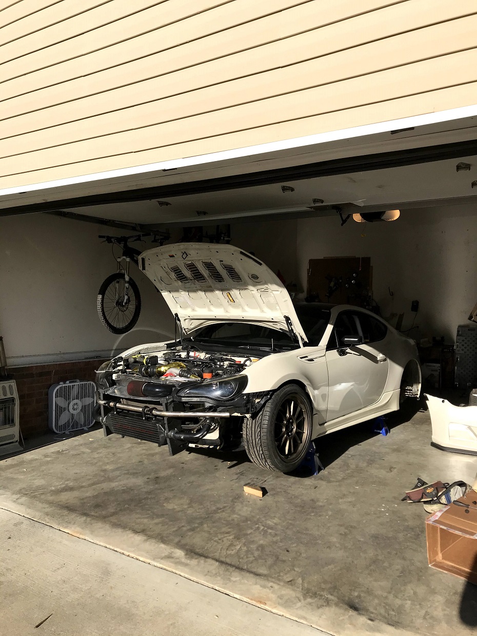

Originally Posted by mrg666 View Post
I also thought about insulating the intake pipe connecting to throttle body. But I thought it would not help much with the heater hose connected to throttle body anyway. Do you see improvement in power?
No power, but my goal was to keep intake temps at bay, which seems to be happening, but will confirm at the track next week.
Initial testing; ambient temps right at 80f, and intake temps never went above 91f driving, and stayed at about 89 degrees on throttle. This is about on par if not better than what I was seeing for N/A temps so that is good.
here is a list of parts I have bought for this little project:
https://www.amazon.com/gp/product/B072L26SYT
https://www.amazon.com/gp/product/B01M3234RV
https://www.amazon.com/gp/product/B07FDQ8XSH
Also I should note that my front area is boxed in (flat bottom not seen as it is attached to the bumper). There is a space between the front bumper and the top aluminum part that creates a low pressure zone (in theory) for the intake air.
Build Thread https://www.instagram.com/mount_tele_lion/
Originally Posted by Symbiont View Post
I swear I will punch your car if you put these on. Right in the face.
Attachment 185498
Beautiful.

Also I would highly recommend "unstacking" the coolers as has been mentioned before. Brought down my oil temp by at least 10 degrees.
