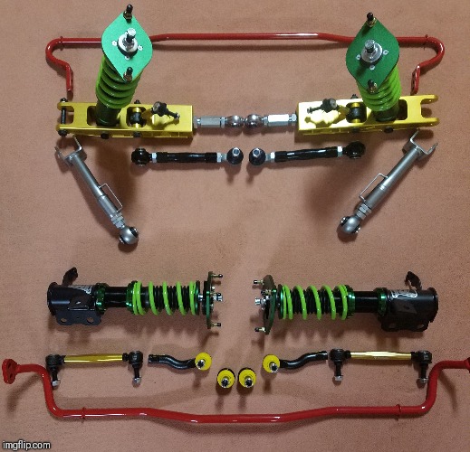

I had 18x8 +45 wheels and read that 18x8 +35 was flush, so I installed a 10mm spacer. (and was disappointed) IMO it was not flush. So then went to a 15mm. Then a +25mm bolt on. Essentially making the front wheels 18x8 +20. IMO, this is flush. (you could go 18x8 +15 in the back even)
Anyway, I have taken my wheels on and off probably like 100 times... I'm on my 3rd set of studs and 5ths set of lug nuts. I hacksawed the extended studs to be able to put the bolt on spacers. Then ended up removing the shaved studs and replacing them with fully extended studs. I have also tried a few different camber bolts and variations. top only, bottom only, both holes, etc.
I have learned a lot about the car and what will fit on it. My suggestions are based on my own experiences with my car and from what other members have posted.
(Part of the reason for all the parts above: I Wanted to know first hand about the installation process, how they change the car, and how they make wheels fit)
