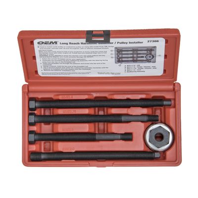

Crank Pulley was a nightmare. 2 different installer kits and neither worked. Autozone ended up having the "Long Reach Harmonic Balancer Install kit" that worked. Though I had to come up with a spacer to be able to reach the nut for tightening it. Almost slid on by hand turning the nut, which I think means I didn't mess up the woodruff key.

What kind of installer did you use? The one I bought was a piece of allthread, and a couple of washers with a nut. It worked pretty well.
Pretty much that. This one has a bearing on it to help it turn a little easier:

That kit is way nicer than what I used. I did buy a bearing to place under the nut to make it easier to turn. They wanted you to use 2 washers with grease in-between them.
