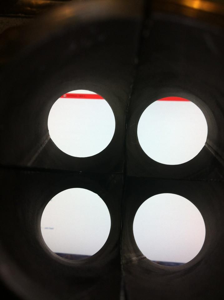

ok havent had much time to work with the car in the last few days, I have however knocked up the merge collector for it.
Just roughly tacked together and will be ported a bit once i get a longer carbide bit.
