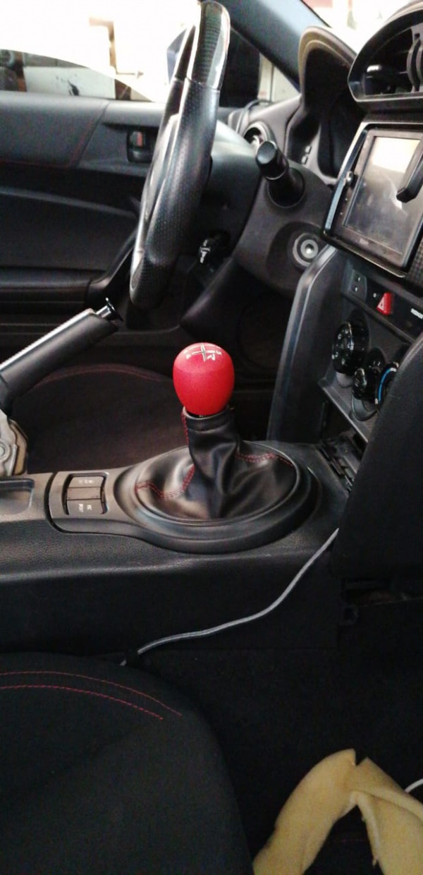

Anyway, I got an MGW shifter and modified it to sit in the right location along with a new Raceseng shifter and a reverse lock-out delete kit from RDE.
