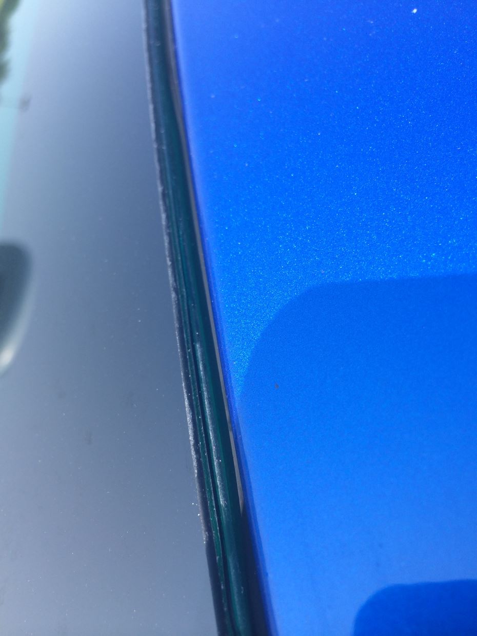

Here is a picture of the top edge of my windshield. Looks like 2 layers of glass to me.

Do you have a picture of the windshield "bug"? It's the lettering etched into the glass, it will be in the bottom of the windshield on the driver's side. The factory glass should be AGC AUTOMOTIVE (DOT 20, which is the Japanese plant).
Another possibility is that it says APTech - AGC Automotive and Safelite have an agreement to make glass to their spec, but it's produced here in the United States (In Enfield, NC if someone is really curious) - when this is the case the APTech logo is used, and I believe the DOT is 1005. If it's something else, post a picture and I can see about getting more info.
I'm betting they used AP Tech glass in the car, it's what we have a lot of in stock - I know we don't stock the Japanese AGC AUTOMOTIVE branded glass - it's a dealer order part and more expensive to get. (AP Tech is also what I opted for, after finding out about the agreement between Safelite and AGC - otherwise I would have opted for the dealer part)

Also, the glass is actually 3 layers - a inner and out pure glass piece, then sandwiched in-between is a printable area where they put the black polka dot like outline and the tinting (known as the 3rd visor frit).

Thanks for all the information @mikalem, I will get a pic of the label in a bit.
