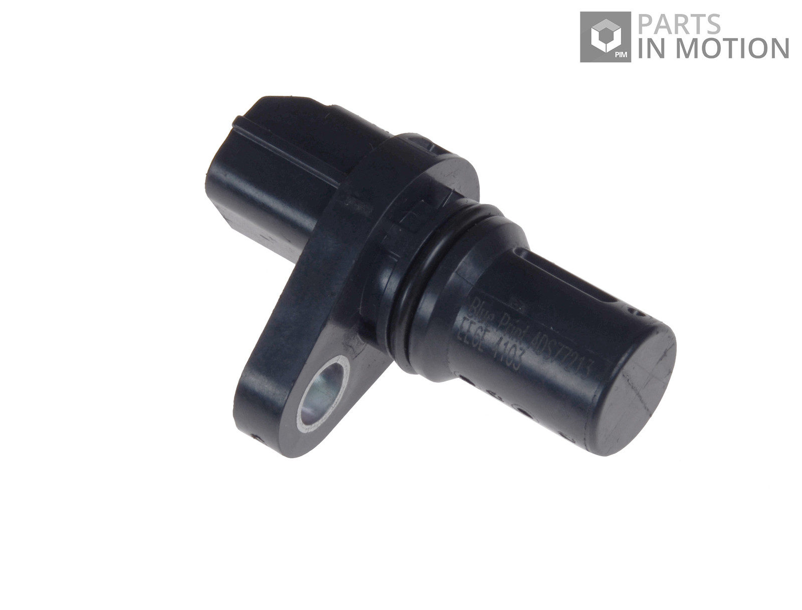

Originally Posted by Second Nature View Post
When you swapped the sensors and OCV Did you swap them with the ones right under them or did you replace it? Looking to do this on my FRS I’m pulling up a p0018. Out of warranty here.
I'd just swap them from Left to Right. If the code changes from P0018, it's most likely that sensor that's bad. Just do the sensor first. If nothing changes, try the OCVs.
Thanks for the quick reply!!
Did a quick Google search... ignore the Part No.s but this is where they are located on the Engine:
