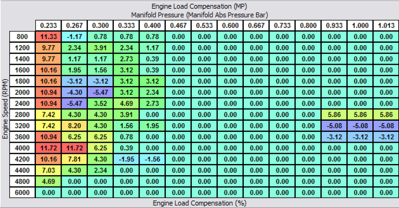

i tried to scale manually and spent 12 hours on the street using vgi and my afr error wont get better than this graph, i tried different front 02 scale that helped a bit but still,
i was wondering if engine load compensation is what cause this issue i read @Tor old thread and he mentions the same issue around 3500 rpm, did anyone came with better engine load compensation or can i just set the value to 1

do you have stock engine load limits?
it forces a lean condition before 3k even if you try to make it richer and then maybe you make richer even the maf voltage around 3200-3400 and then it goes too rich
also you have ecutek or am i wrong? you could set the racerom v10 and enable the Closed loop fueling , it fixes the afr for you
im using ecutek but i dont have racerom, and i would rather fix the issue than work around it

well rr10 CL works extremely good i have racerom license, i could set it up for you for a small fee if you are interested
anyway you haven y answered about engine load limits, and if at 3400 rpm is that rich, maf scaling at that voltage is too high

yeah im using stock engine load compensation and i dont really know what im supposed to do with it, i tried to work with maf scale but i have been chasing my tail for the last 5 months

i asked you about "engine load limits" not compensation !

yeah that stock too i havent touch lots of tables on this tune
I set all values above 0.4 bar to 1 before starting MAF scaling (in the examples 0 as RomRaider use %). I then start out with a good smooth scale, make 2-3 WOT pulls and check where it has peaks and dips. Example from one of the last I did:
I then I roughly correct the dip/peaks from 0.9 bar and above:
With those corrections let the owner do full logging. Depending on the fuel errors I either do MAF scaling/Load limit corrections (emphasis to differentiate from ELC) and then repeat the above steps (without zeroing out).
Or if the fuel errors are small in both OL and CL (as they were in this example), I only do load limit correction, OL MAF scaling and otherwise apply the error corrections in the ELC table (CL corrections below 0.9, manual corrections above to control WOT curve). In this case, it ended up looking like this:
Which produced this result:
Then I let the owner drive for 150 miles and then do a check on the LTFT. In this case, the WOT LTFT was 0.78 after 150 miles.
I this case it was lucky the initial MAF was pretty close in CL, and I had it done in 2 revisions and could move on to ignition timing. Otherwise it takes a few more revisions to get the MAF scale done in between.
This is the method that works for me. Others may have other procedures. Not that many even bother with the ELC table. For my way of doing it, it is essential.
The ELC table is going to be as individual for each car as the MAF scaling. But they always have the same pattern for a given header. It depends on where your MAF scales average the differences out. I don't like applying more than 6-7% corrections max in ELC (except below 0.3 bar as stock). If the corrections needed are higher than that I rescale the MAF again. Or if you need to apply large negative or positive corrections over the entire table, your MAF is not averaging the differences out (either too high or low).

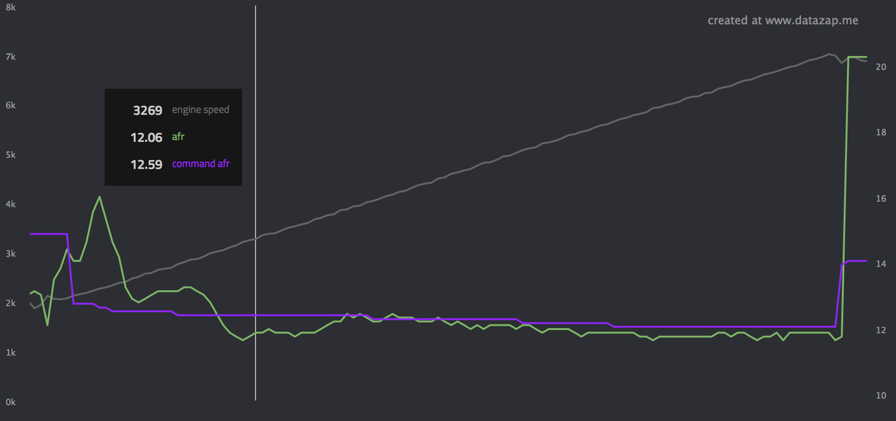

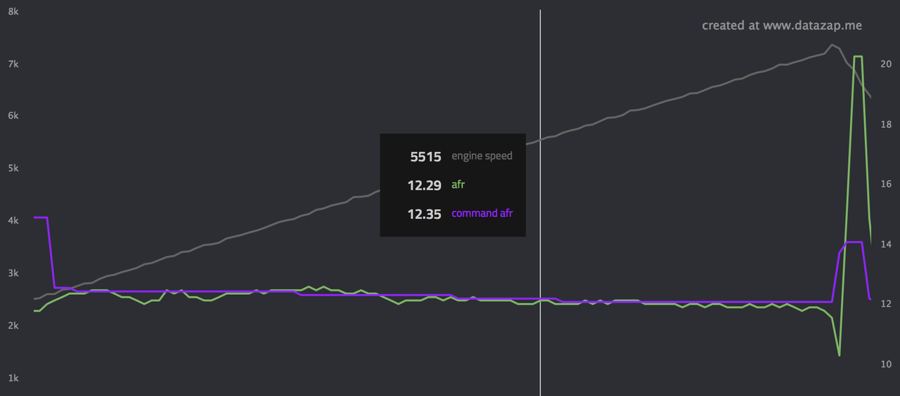

i ended up buying racerom, and the first thing i noticed is how inaccurate the front o2 sensor is compared to aem wideband, this is stock scaling in the graph i tried different scaling i found online but there werent any better so i went back to stock o2 scaling,
this was one of the main issues i had i trusted the front o2 too much and i was wondering why i was having issue getting my afr close, right now my highest afr is 12.7, lowest is 12.1 but with afr smoothing the graph its between 12.58 and 12.33 while the target is 12.46 i might try to get it closer and smoother if possible before going to dyno

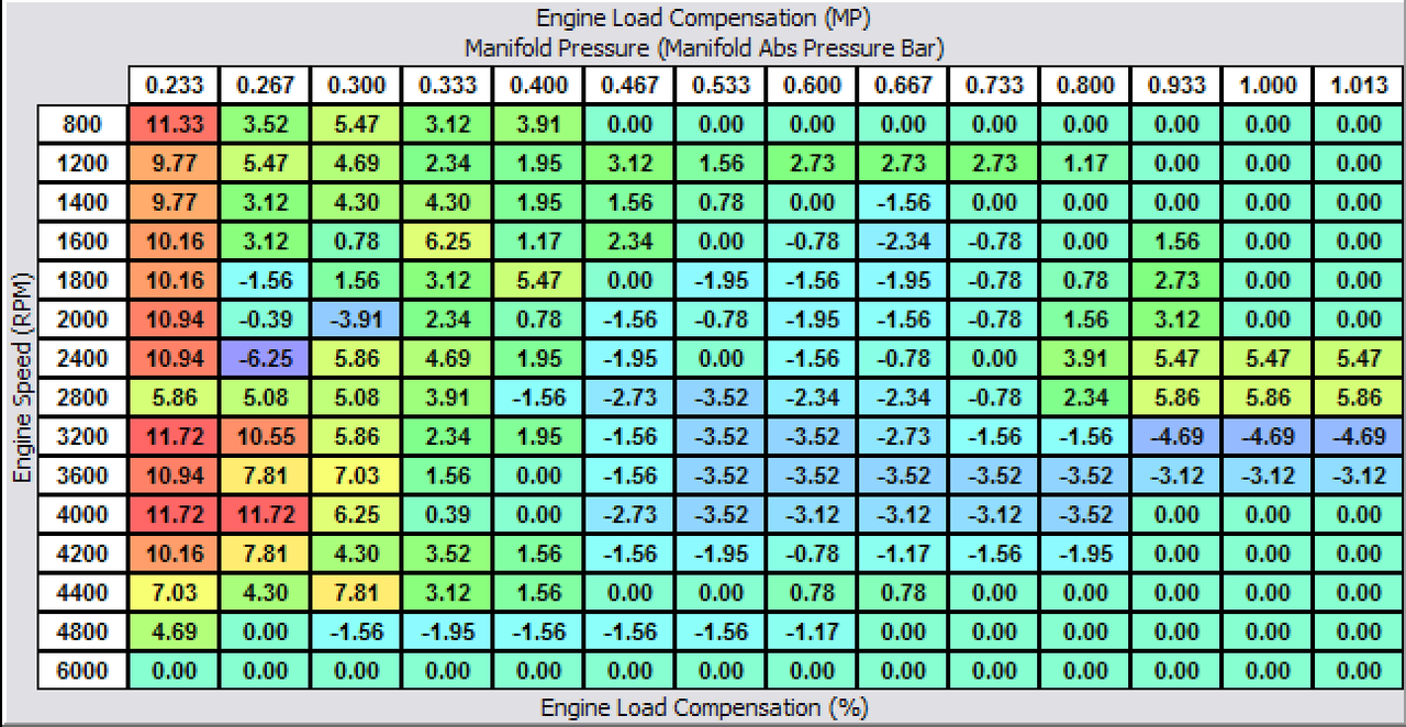

i tried using engine load compensation i have set 3600 to 0.95 and i think my afr looks the same as before maybe it did improve only at 3600 but not around 3590 and 3900
from what i read about elc i think it doesnt effect the actual afr just the target right?
