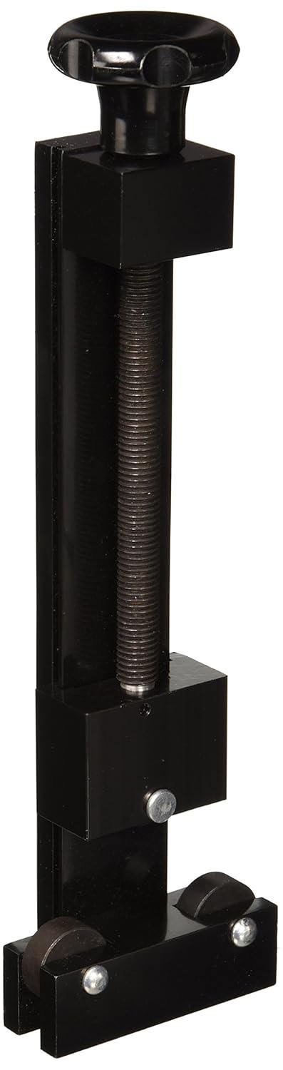

One of these days I'm going to get one of these to make it a little easier.

Not even sure how much you would see from cutting a filter open. I just send in my oil for analysis each change and get detailed reports.

I was talking about the construction. In particular how much media is in them. The cheap Fram filters for example have very little media in them.
