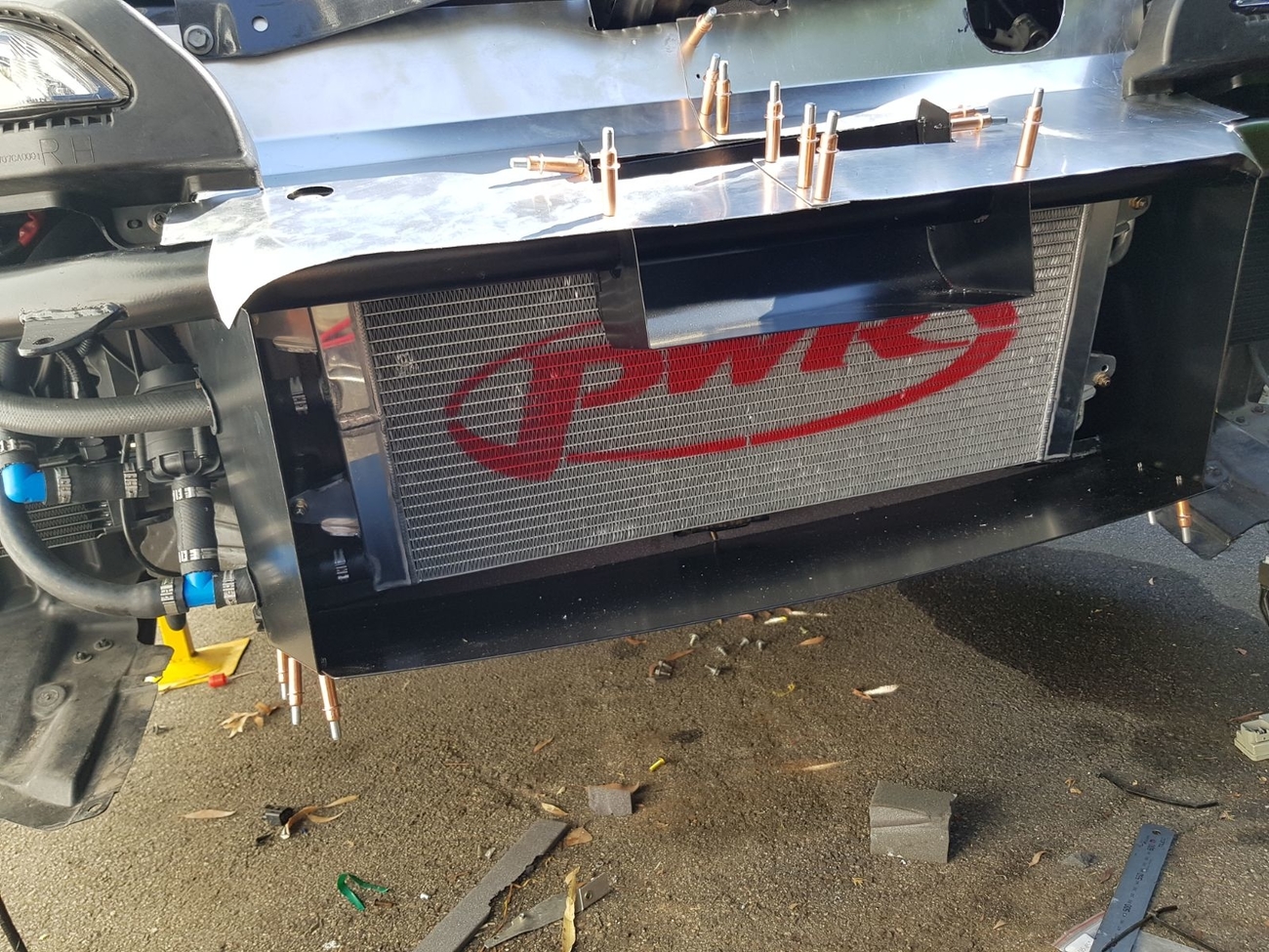

For what it's worth here is mine. Custom built crash bar and shroud around the radiator and heat exchanger on the Water-to-Air intercooler. Fresh air is ducted from the enlarged front grill up into the intake which is thermally isolated from them radiators.
Engine oil and transmission coolers mounted where the foglight/indicator panel used to be.
