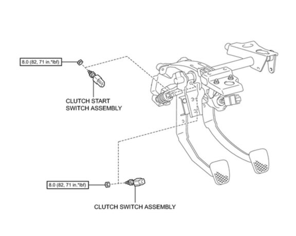

You should be able to mash it to the floor all day long. The pedal lands against a hard stop which has a cheesy little rubber button attached. I wore through mine long ago and replaced it with an adhesive-backed felt pad.
The switch should be adjusted so that it closes just as the pedal hits the hard stop. This is the Toyota version of the manual.
Good point. Hm, I'll double check the stopper too maybe mine needs replacing or got knocked off.
They're so thin it's ridiculous. You're good as long as you don't get a metal-to-metal clank when you bottom out the pedal.
