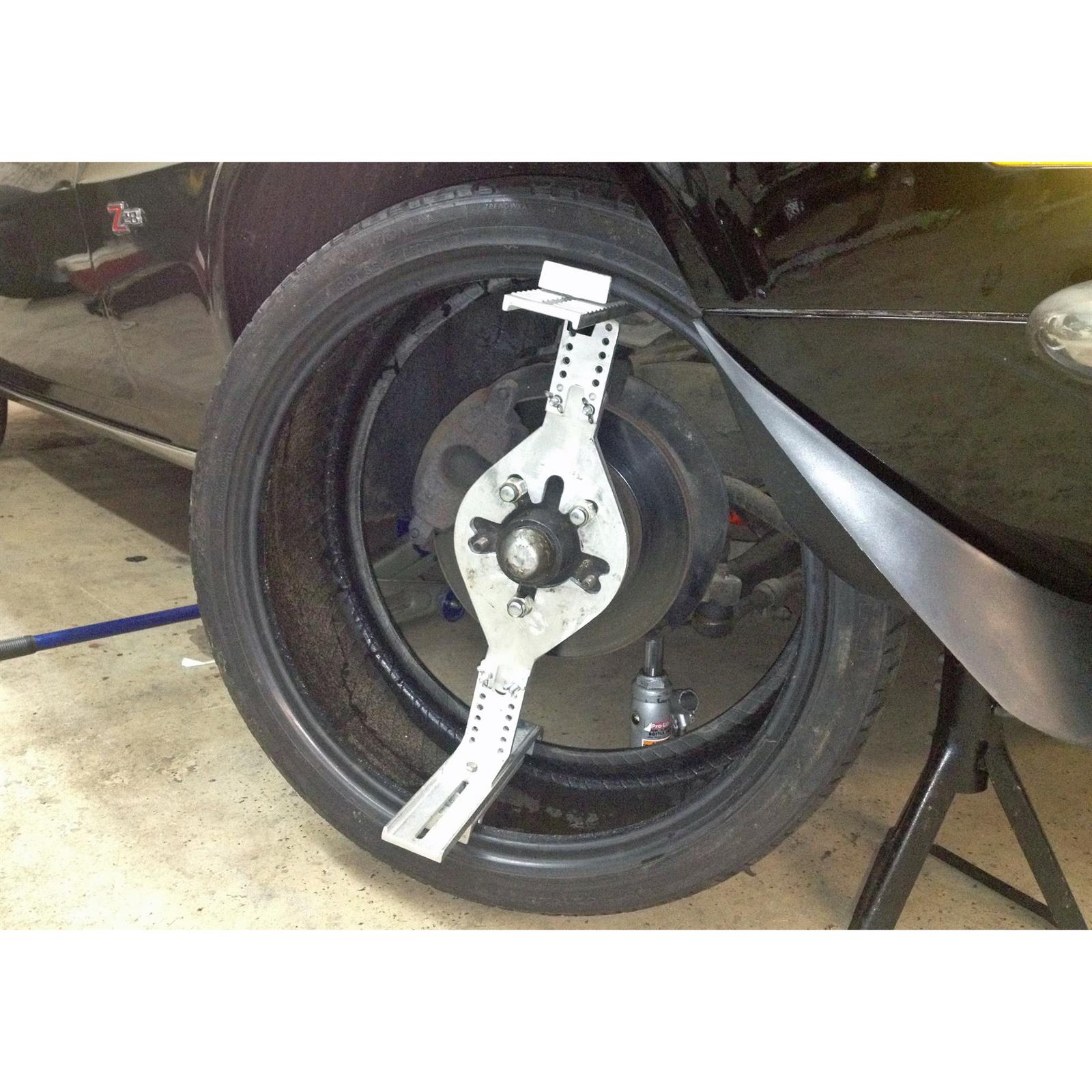

The Plan is the run it square. I went in with a friend to buy one of those wheel size calculators. You mount your tire to it, and mount it to your hub. You can then move the tire around and calculate the offset of the wheel needed. So I should be able to get the perfect fit. Hopefully. Hope to fit it on an 18x11.

Wheel Fit Kit (Click Picture)
