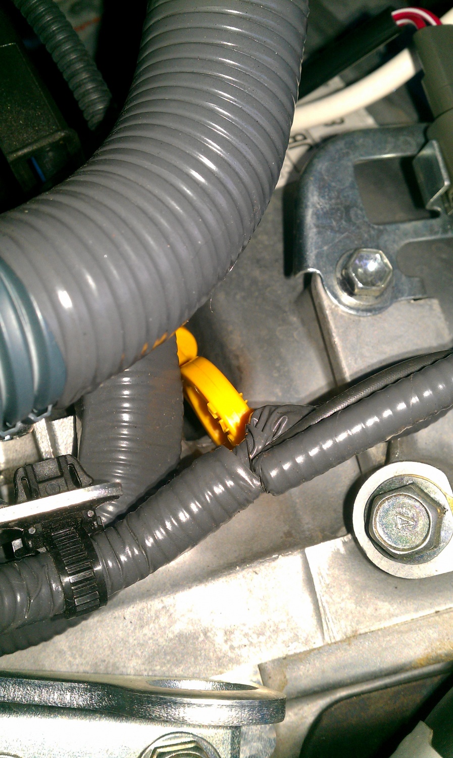

I checked it out and realised I had NO TRANSMISSION FLUID.. don't understand why, dealer said maybe they forgot so filled it up.. its ok now, done 1900km's on it so break in period is over for me

anyway the manual tranny has a dipstick like the subaru wrx's underneath all the cabling in an awkward position on the side, hard to find but it was found.. eventually.. its where the transmission filler plug is on the side.. not sure if the gts has it like the gt does but worth checking.. if not you'll have to either jack up your car and remove the underneath cover or try bend in from the top and remove the filler plug on the side of the transmission and insert a dipstick to check if there is any
hope this helps

This is a first time I see a dipstick for trans oil its really cool and handy!
I stil can't beleave. They forgat to put oil!
