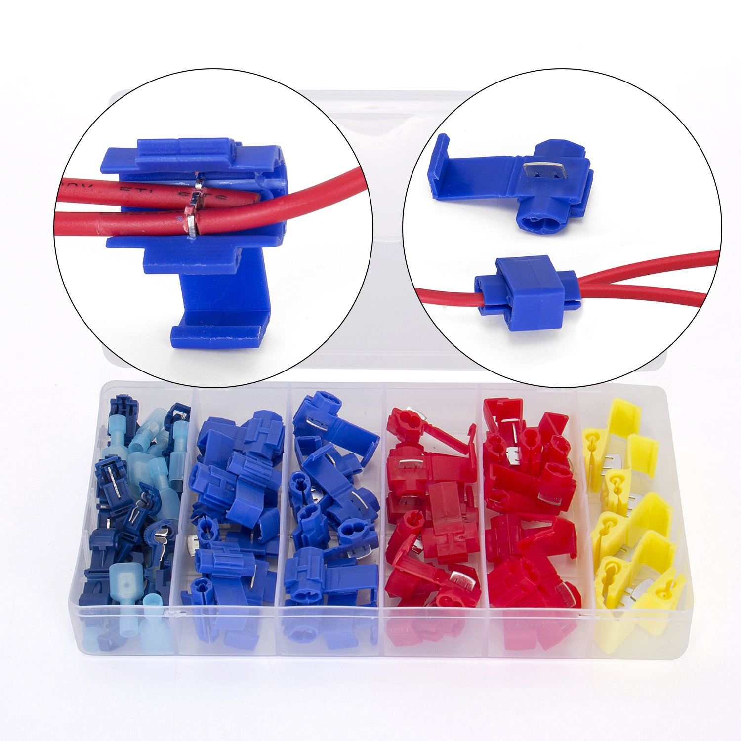

A couple follow-up questions (please excuse my ignorance, no electrical expert here):
  1. To tab into the turn signal in the headlight and into the side marker, can I use a t tab connector like this one?
  2. What kind of wires should be used? Length? Where to buy them?
  3. The white/red wires should be cut and disconnected from the original source and tapped into the turn signal in headlight, correct?
  4. The black wire (ground?) should be left alone, correct?

It's better to solder and heat shrink them than T-tapping, you might run into shorting issues if water gets introduced to the wiring. 18AWG is fine too, just make sure you get the multiple stranded wire, there is also a single wire but you don't want that one. And I am going to assume you have a BRZ, so that is as far as I can go with my advice! I hope I helped a little bit!
No. You can't short + to +. That's not a thing. The problem with the taps is corrosion and loss of conductivity.
