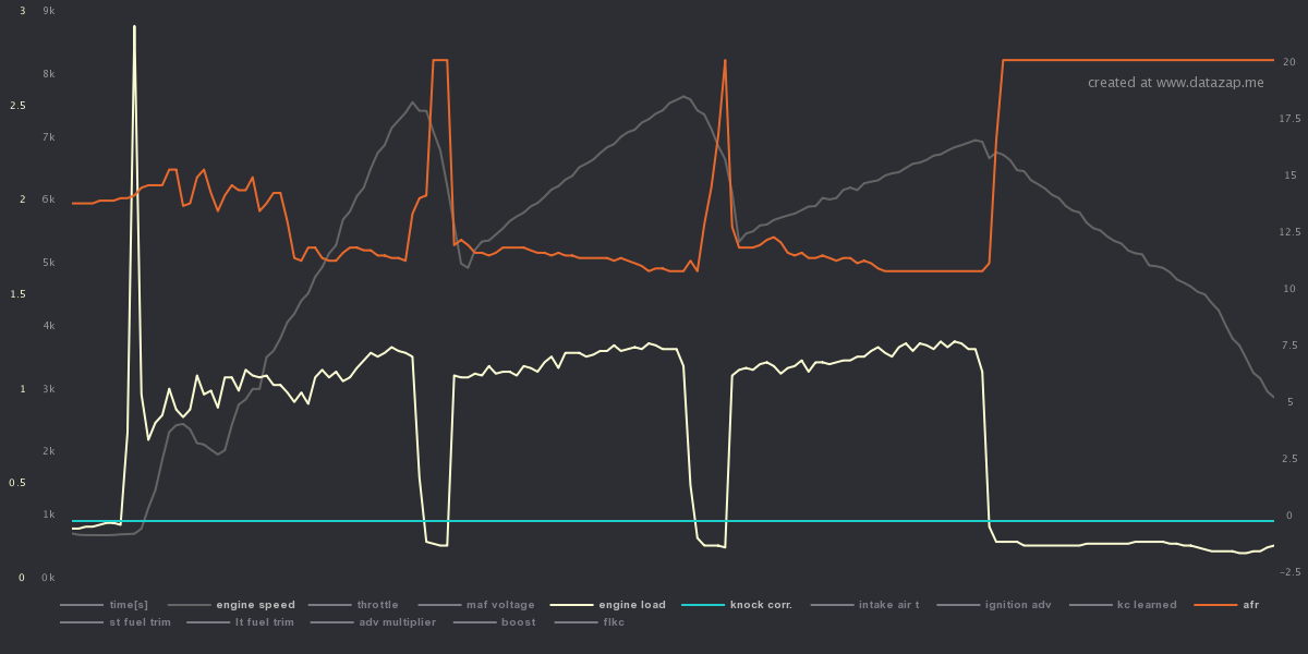

So after being able to smell a bit of gas after doing some pulls I logged a little launch to redline 1st, redline 2nd, and 3rd to 7k rpm and it's at 11.02 AFR from about 6-7k and it seems really rich in quite a few places. And once again no knock correction. So to me it looks like the stage 1 tune at least is super conservative and probably for 91 octane.
Anyone have any input on the AFRs?

You need to log afr commanded as well, with that you can determine if you need to scale your MAF or not.
Attachment 156948
http://www.datazap.me/u/jermmx5/stag...00&tmax=617.00
The 2017 fuelling works different to the old cars, theirs extra tables one ecutek calls "power AFR" it doesn't seem to be identified the the opensource definitions I have seen, however shiv may have better defs. The extra tables are used as well as the normal OL fuel tables (and their is two of those as well)
How do I change what the OFT logs?
Similar to PE table in GM ecus?
