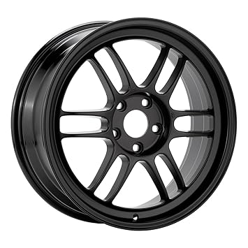

Just checking to see if anyone is running 17" Enkei RPF1s with 15mm spacers.
Was there enough cavity clearance on the RPF1s that you didn't need to shave down the stock studs?
I'd have to take a tire off to check for sure, but any info would help.

Answered my own question. FYI:
Stock studs from brake disc to tip: 25mm
Cavity in RPF1 rims: 12mm
So with 15mm spacers, I'll have 2mm left over. Should fit fine.
