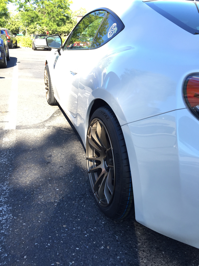

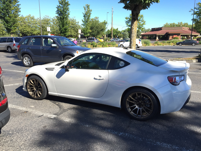

Setup:
Avid1 AV20 18x9.5 +38
Continental DWS 06 235/40/18
Name:  driver side_small.jpg
3.5 finger wheel gap, only have about 2mm clearance to the spring perch - no rubbing as of yet. Was hoping to get some eibach sportline springs soon but at this point I'm almost certain I'll rub just due to natural camber from the drop. Likely I'll have coils coming soon to give me peace of mind...

Originally Posted by Fainten View Post
I have 18X9.5 +35 wheels, are your wheels rubbing on your stock suspension? or rubbing/scrapping at all.I want to run the same tire size as well but i want to know if i can run that width on stock suspension
Every car is a little different so it's a bit of a gamble...
I'm running 18x9.5 +38 235/40 and I BARELY clear the spring perch, maybe 1-2mm (less than a finger). I did a lot of research before committing to my setup and anticipated more like 5mm based off other's build on here (hence the gamble). In short, I went 235/40 as I knew it'd be a tight fit.
+35 will give you an extra 3mm to work with, so in theory you should be fine running 245/35, but again it's hard to know for sure until you test fit. Buy the wheels you want, test fit, and then order tires once you know what you have to work with.
Waffle86 is offline   Reply With Quote
