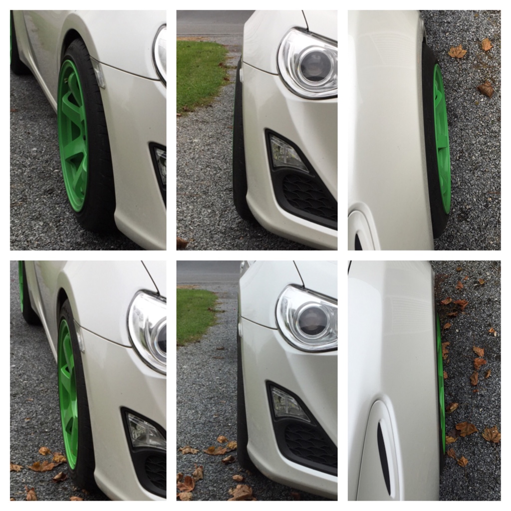

Originally Posted by jshadeck View Post
Fit should be fine, but a 9.5" wide front wheel w springs (not coilovers) will poke outside the fenders. It doesnt bother everyone but its there. Also, with springs and a 9.5 +40 you wont be able to camber much at all, or the wheel will hit the spring perch, so u cant camber to tuck the tire to eliminate some of the poke
Attachment 111412
I feel like I've searched this entire thread but still would like confirmation on my understanding before I can commit to a direction on wheels & suspension...
Assuming a square setup:
1) 18x9.5 +38 on 245/40/18 w/ eibach sportlines will fit w/out rubbing. No room for camber adjustment due to stock perch. No camber bolts needed to remove natural camber from lowering. Coilovers required to fix poke.
2) 18x8.5 +35 on 235/40/18 w/ eibach sportlines will fit w/out rubbing. Camber bolts optional.
3) 17x9 +42 on 245/40/17 w/ eibach sportlines will fit w/out rubbing. Very little room for camber adjustment due to stock perch.
4) 17x9 +35 on 245/40/17 w/ eibach sportlines will fit w/out rubbing. Camber bolts required to fix poke.
5) Coilovers magically make everything listed above fit.
Please correct me if I'm wrong about any of this - I've read a lot of conflicting information across multiple threads to get to this point
Waffle86 is offline   Reply With Quote
