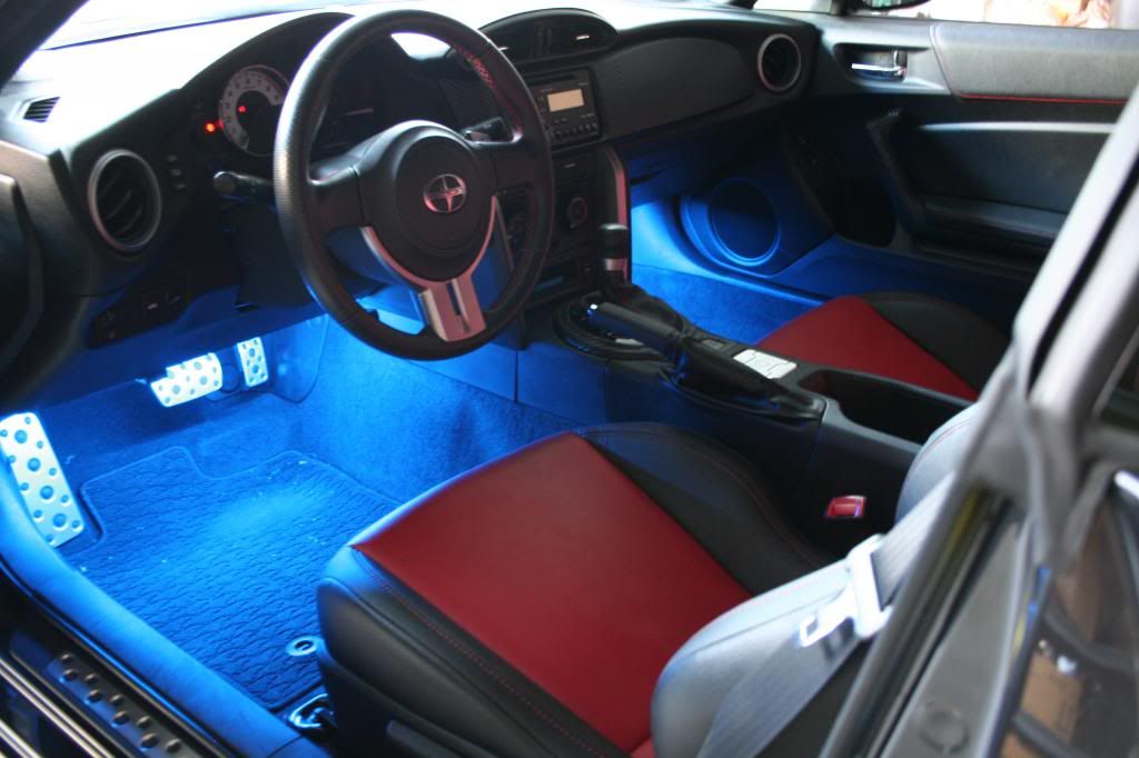

Originally Posted by Chaetagnath View Post
No, it doesn't seem to hit my knee at all. Of course, the switch can be put almost anywhere to fit your driving position.
SUPER THANKS TO CHAETAGNATH! Providing me with so much help thru messaging i've finally got everything hooked up! My first time dealing with wiring things so i was really nervous with it.
Heres some pictures of the center console plaque connected with the Footwell lights! One bad thing about this plaque is that it heats up really quick =/ and gets hot... dont know what i should do.. so right now it's just set to on during the dome lights come on. etc...

HUGE thanks to @Chaetagnath . wouldnt have been able to do this without your help along the entire way.
only problem i have is the dome light stopped working on me. might be the led connector, but ill see.
anyways here ya go.
hooked up to a spdt switch so it can either stay on even when the car is off or come on when the car is unlocked or doors open. basically functions just like the dome light. mounted the switch near the trunk release
