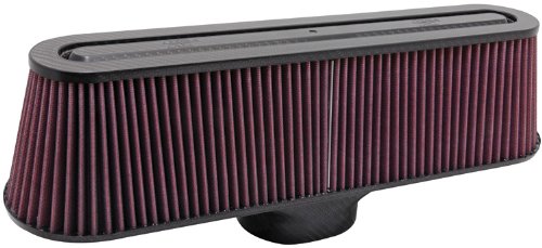

Yes. Run the intake with a 45 off the throttle body and straight behind the bumper. Looking for a good filter now.
Thinking about this one:
