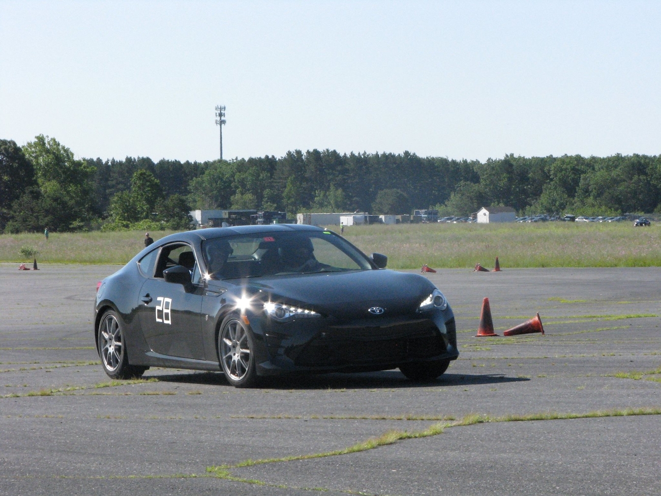

Project 2017 86 - C Street
Update 8/11/2017
So I've decided that I'm going to start slowly going towards STX because I really want some power parts for the street and for autocross, so that will be happening over the next few months and the bulk during the winter. Planned parts list will go down below soon.
Current State
  • Alignment - 1.2 up front, 2.4 in the rear, and 0 toe.
  • 20mm Whiteline front bar on stiff
  • Stock shocks with TRD springs
  • Custom muffler delete that is too loud most of the time
