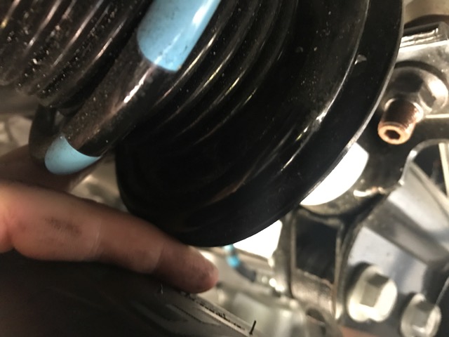

The wheels and tires came in today and I test fitted them and I'm a little worried about the clearance. The TRD forged rims are 7.5 width but 42 offset and I got 7.5 with 48 offset and this is the distance between the tire and the spring perch:
Attachment 152338
It looks fine for now but once I get the additional camber I'm worried it will put me too close at the top, so I might pick up some 5mm spacers, unless anyone has some input.

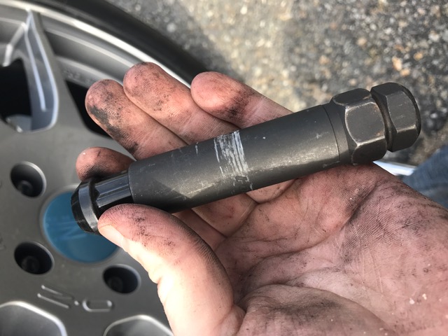

The next issue is the lugs that came with the rims:
Attachment 152339
The holes in the rims are so small that I need to use this special spline tool, does anyone know of some extended lugs that will fit in there?

I said 1/8 toe IN on the rear.
No more than 5mm spacers on the front with stock wheel studs but if you can fit a credit card between the tire and the spring search you are good to go.

Haha I'm glad you found me on here Bill! I would've been stuck with some bad alignment otherwise. And awesome I figured as long as there was some room I'd be fine, and I saw a thread where someone else was running 17x7.5 +55 with no issues so I'm less worried now.

And I'm considering returning the rims I got because of that stupid spline tool, the reading I've done has said that if I use impact tools on it (Like I would do every event) that the tool/lugs will get destroyed, so maybe I might just return them for some RPF1s, but I'm just worried about the strength of the RPF1s if I hit some bumps or a small pothole with them ever. Anyone with the RPF1s know?
nico_rsx 04-17-2017 11:27 PM
I've used those kind of lug/tool for some time. At least 2-3 years of Autox. 10 event per year. They are starting to show some wear, and would have needed to be changed if I didn't changed car.
I think that's not that bad. BTW, I used an impact with them all the time.
You can also get the kind of nut that stick out of the wheels holes. That's probably what I'll do with the BRZ.

I've been looking around for something exactly like what you're describing but I havn't had any luck, maybe I'm using the wrong search terms?
strat61caster 04-18-2017 12:54 AM
Extended Lug Nuts
Gorilla brand is relatively affordable and easy to find on Amazon. Beware the longer ones may require a deep socket to get on and off which may be a bit inconvenient.
