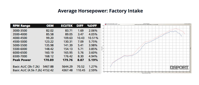

Originally Posted by guybo View Post
http://dsportmag.com/the-tech/scion-...ing-ecutek/10/
With all the guessing and uninformed conjecture on here, I'm a little baffled. There is an independent group that actually tested a bunch of intakes with a tuned and untuned car. I don't understand many of the responses to this thread- this is proof of what an intake will do for your car.
read the article but found it kind of confusing, what was the end result? what was the best intake for our cars? they weren't really clear with that part unless I missed something
They never overlayed the tuned intake dynos with tuned stock dynos. Probably didn't want to upset their advertising clientele. Don't bother with an intake.

They definitely should have put these within the same chart but wanted to post them here just to save everyone the trouble of digging through. Looks to me like some of the intakes definitely make a difference when tuned compared to tuned on stock intake.
