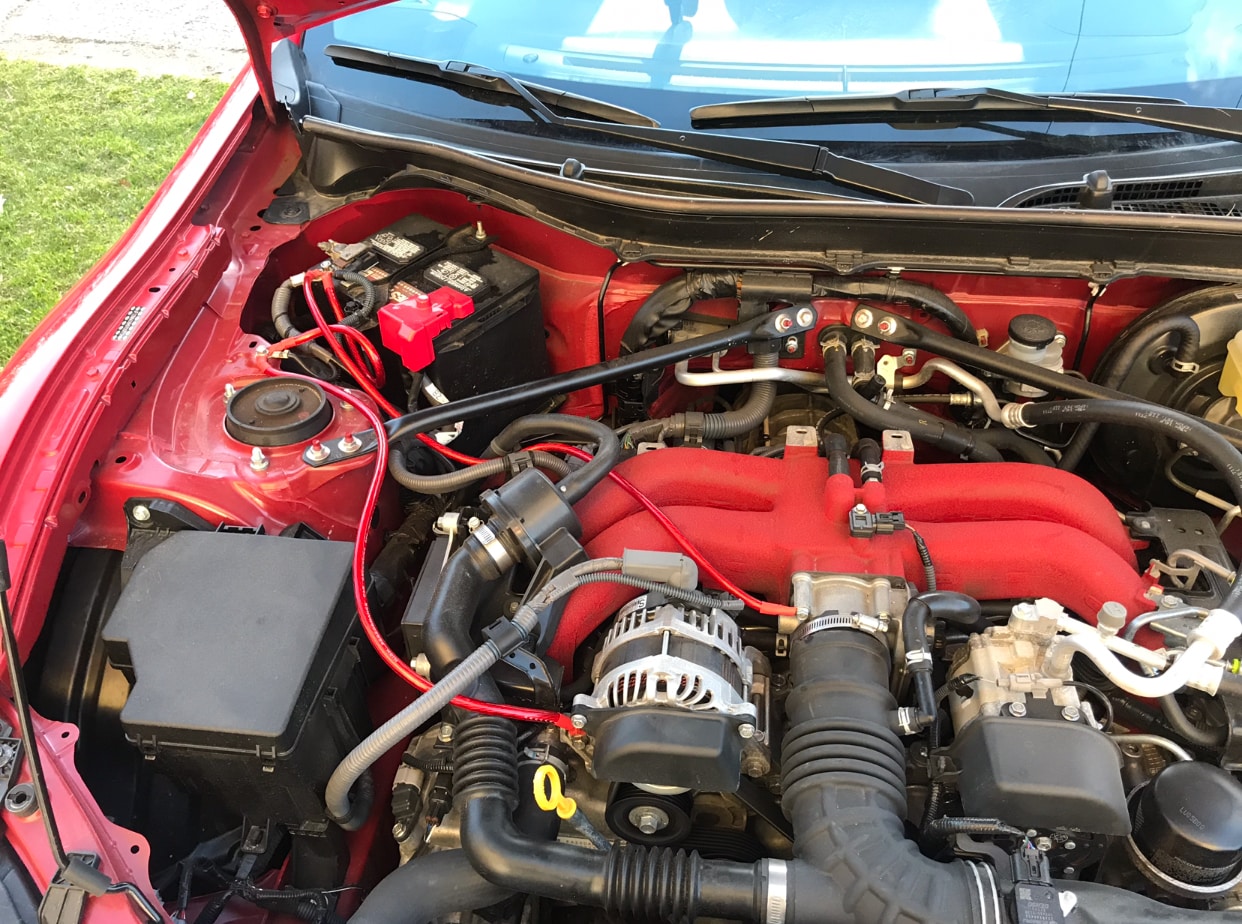

Started my big 3
Preparing for my stereo install
I have my stereo in, but neglected my big 3 because I'm lazy and dumb. I will be doing it with 0 gauge wire, and the from inspecting the engine bay it will be the easiest big 3 I've ever done haha. My question for you is why did you route over things instead of tucking wires?

Red wires for ground (wires). Is that a good idea?
I know the car is red, but it just seem off and unnatural.
Also, when running a grounding kit, isn't it a good idea to have the wires go from fender to fender while making connections in between (block, manifold, etc.) to tie several engine grounds together to make one large ground array?
