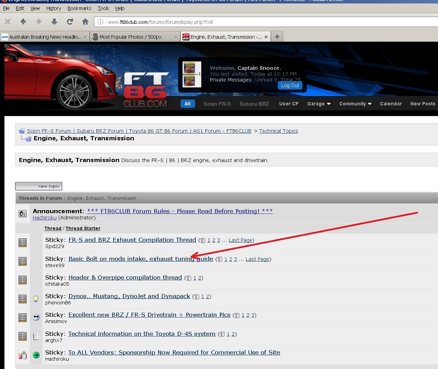

http://www.ft86club.com/forums/showthread.php?t=81493

Thanks Captain, but as I mentioned in the original post, I've been through literally hundreds of posts on this forum including the one you highlighted.

My post was in response to you having read many of the related posts, including @steve99's gospel, and expecting that there is something magical you haven't seen.
