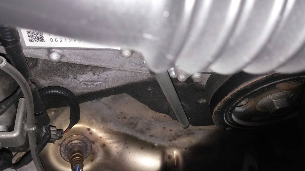

Hey guys im new here i just picked up a 2013 silver ignition frs 6 speed mt with 52k miles and unfortunately it has an oil leak; no oil on the floor but its all over the timing cover is there a simple way of fixing this or will the engine have to come out and get resealed?
Silverfrs86 is offline   Reply With Quote
Old 11-12-2016, 06:54 PM   #359
Silverfrs86
Join Date: Nov 2016
Drives: Silver Ignition 2013 frs
Location: Miami FL
Posts: 11
Sent from my LGMS631 using Tapatalk

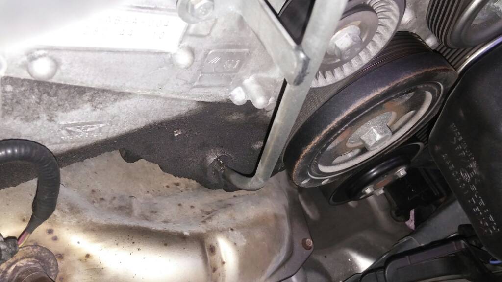

Old 11-12-2016, 06:55 PM   #360
Silverfrs86
Join Date: Nov 2016
Location: Miami FL
Posts: 11
Old 11-12-2016, 08:16 PM   #361
Pretty sure the engine has to come out. People that had it done at the dealer lost their cars for several days.
Take a look at EM 18 to 20 here - http://www.ft86club.com/forums/attac...1&d=1413834741

Hello @Silverfrs86 ...... and welcome to FR-S ownership and ye ol forum .....
Yep, your engine is seeping oil for sure.
If it is out of warranty, I would suggest that you spray some degreaser on the area and wipe it off best you can.
After a few miles, check and see where it's seeping. Is it just around the dip stick tube or along the seam between the block and cam chain cover?
Then you can decide how to proceed. If it's just the dip stick tube, maybe it can be fixed without removing the engine.
If it leaking at the seam, the engine is usually removed to re-seal the cover.
OR
You could just let it seep ....... the engine won't bleed to death.
Hell, back in the day, if an engine didn't leak somewhere, either it was out of oil (borrowed that from @Tcoat) or the owner just wasn't payen attention.
Ever wonder what causes those spots of messed up asphalt in parking lots ..... ??
They weren't ALL cause by Harley Davidsons parking there .....

Yeah, I'm with @humfrz. That's just weeping a tad. Spray it down with some degreaser and hose it off. It took a long time to get that way. Once you find the source you can probably just wipe it down once in a while with a shop rag and some wd-40.

Thank you guys for your help very informative. Ill be washing it off and finding out where its coming from but ill just have to learn to live with it; the oil doesnt seem to be getting any lower its exactly where i left it at after i changed the oil
